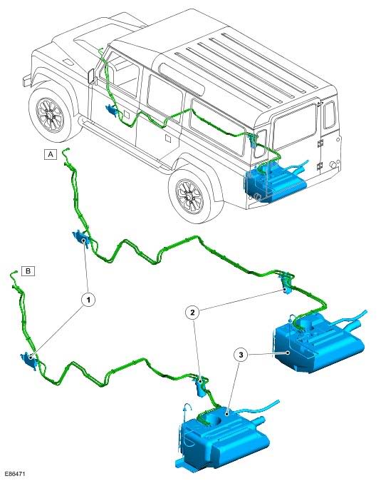

On the Puma??? I'm 100% sure there isn't an in tank fuel pump. Here's a pic from the manual: ![]() Click image to enlarge Cheers, Tim Admin note: this post has had its images recovered from a money grabbing photo hosting site and reinstated ![]() |
