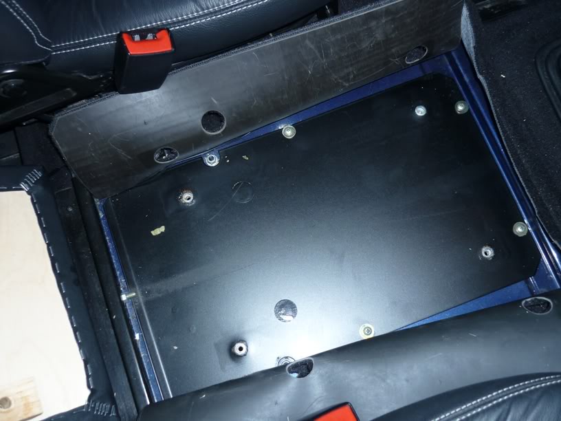

I posted this on, "What did you do in your Defender today", section when I fitted mine. Did not want to drill any more holes in either the safe or the floor as I am still thinking of locating the Eberspacher heater there, or under the rear seats. Not sure yet hence the reason for not fixing any more riv nuts!

This begs the question as to why Peter set it up in this way? It needs to be level, but there are no shims on the base. It needs 4 fixing points, but only the rears are able to be used and with the rears its still very close to the front. I also found when playing about with the position, that a better place is further back - after all the safe has a "step" at the back to get it over the flange in the floor/the bulkhead bar. If the rear points are used in the vehicle floor, the cubby when lined up on top is awkward for the elbow, yet further back it's fine. I also think it would be better if the cubby was cut down from the top to make it more shallow, but in terms of getting someone to do this I'm drawing a blank so far. I could do the cutting myself but then it needs an upholsterer to re-trim, so everything starts to get expensive. Maybe one way to deal with it is to keep it further back by using two lengths of bar stock, say 50mm by 2mm and whatever long - use the four LR fixing points by drilling through the bar stock and fixing it to the floor riv nuts at the front, then safe to bar with the already cut front safe holes, then some shims under the safe at the points where the rear riv nuts are located, through the bar again etc. The Epersbacher will fit in there definitely. I want to mount my CB in there as well, probably side on towards the driver, then run the mic wire to a panel mount in the front of the safe on the left side so the mic cable socket can plug straight into the box. Putting on the drivers side will bring it a little close to the transfer box lever I think. Also with shims installed it gives the issue of the exhaust and inlet going through both safe and floor, but there being a small gap between. |

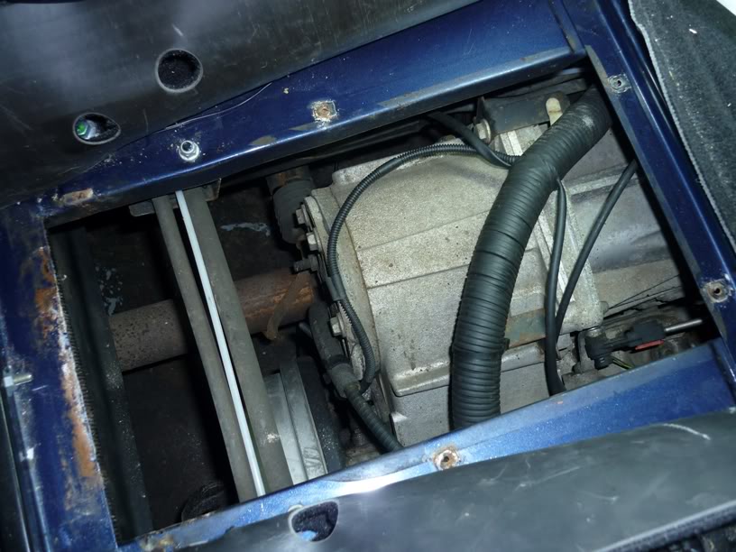

Prompted by Gly's comment above and partly out of curiosity as to whether a Webasto would fit under, I removed the cubby box and blanking plate. There's not much room above the transfer box but if you could move the fuel lines and fabricate a box for the heater/safe there's quite a bit of room behind the transfer box. ![]() Click image to enlarge [/img] ![]() Click image to enlarge Admin note: this post has had its images recovered from a money grabbing photo hosting site and reinstated ![]() |
