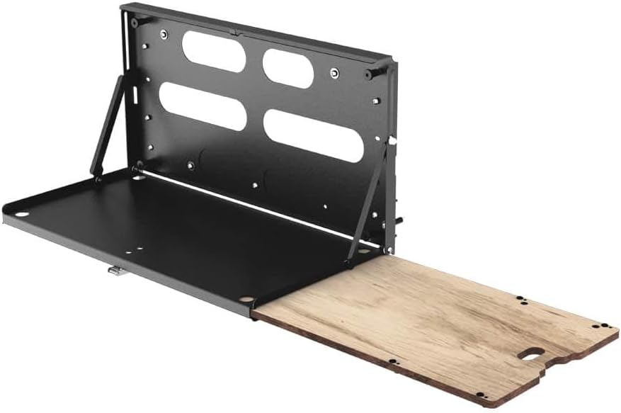

I notice there are a few variants of these tailgate drop tables for Jeeps on Amazon.
This one caught my eye - no idea whether it fits as well as the one above - seems to be about 48mm longer (before the extender is pulled out) so not sure whether it would still fit on the existing Defender bolt holes as shown above (I think that one 600 wide))
https://www.amazon.co.uk/Front-Runner-Drop...K9QZNFGCWQ
Have this table fitted to mine.
Nice. I expect the offset is because the existing bolts in the door line up exactly with the back frame sides - I'd be tempted to do something similar to the OP's solution with angle brackets to get the centring.
Thanks for the photos though! Thumbs Up Steve N | 21MY Defender | 08MY Discovery 3 (history) | 06MY Discovery 3 (ancient history)

Much as I like the extendable one for the extra space, I notice that it blocks access to the bin in the tailgate door unlike the (cheaper) one described by the OP Steve N | 21MY Defender | 08MY Discovery 3 (history) | 06MY Discovery 3 (ancient history)
Easily fixed with a hacksaw though. 2021 Defender 110 X-Dynamic HSE D300 MHEV

Last of my bits turned up today - the Bosmutus Tailgate Table itself
Approximately three weeks in front of the car Big Cry
And SWMBO has just accused me of "I'm sure you're trying to build another car in the gragae before your new one has even arrived!" Shocked
On balance I might actually have more Jeep than Defender bits in my garage right now! Big Cry
But I have a cunning plan... Whistle Steve N | 21MY Defender | 08MY Discovery 3 (history) | 06MY Discovery 3 (ancient history)
