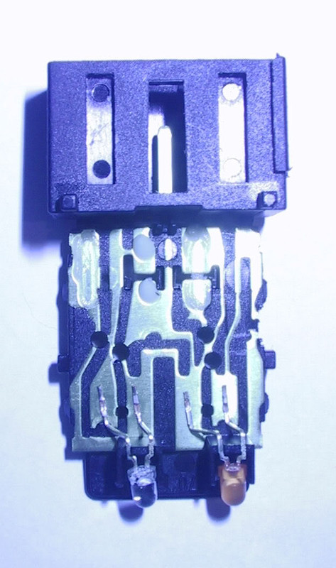

Option 2. Modify your exist switch's internal layout, to turn it into a live-switching switch.
This is quite easy, and requires a small cut in the internal circuit layout, and a loop of cable from Pin 4 to Pin 5 in the Black connector.
Genuine YUG000540LNF, as supplied ( switch opened up) -
Modified, with position of cut in circuit shown in Red -
By cutting the track at this point, you separate pins 3 & 4
The revised circuit would be as follows -
Pin 1 - Incoming Live from Main Beam/Dipped Beam/Side Lights/Permanent Live (as applicable)
Pin 2 - Live from Dash Illumination
Pin 3 - Switch Earth (for indicator LEDs)
Pin 4 - Switched Live output to Accessory or Relay
Pin 5 - Live in from Pin 4 (for Orange 'tell-tale' LED)
. Paul.

I have a question about converting the YUG000540LNF switch.. I can't for the life of me work out how to open it.. However, I have noticed with my switch, that the PCB tracks are visible at the bottom.. and apart from being back-to-front, the PCB tracks look exactly the same as the ones in your photos. Did your switch have a double-sided PCB tracks, or have I got some kind of newer version where the tracks are on the bottom of the PCB? I can see the two holes that you mention to cut between.
Does this look different to yours?
Do you think scratching the tracks that are visible through these "access holes" would work, without having to open the switch?
Mmm. Maybe I'll just try it!
Thanks.
