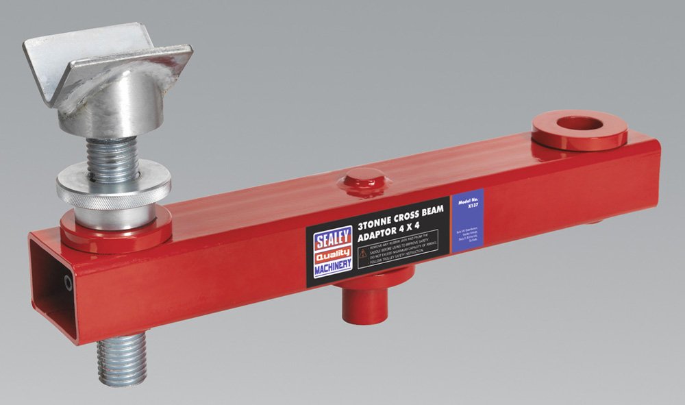

Im trying to find the tool - but you can get an attachment for the jack to position par on the diff case and part on the axle to lift squarely. Also - those lifting D3/4's or RRS - there is an attachment you can insert into the jack that uses the LR jacking point on the chassis Here it is: ![]() Click image to enlarge ![]() Click image to enlarge https://www.amazon.co.uk/Sealey-X137-Cross...B00CM9B38A Mike |

I come back to jacking on diff casing is the correct location - technically jacking on the radius arm isnt correct (although i do it too!)
The advantage of that sealey device is you can then position axle stands in the correct location. Also a point on Jacks - i have some good trolley jacks 3-5t ones, but the defender isnt that heavy - especially when your only lifting 1 corner or the front/rear Mike |

Ok, so with this Sealey device, the spread of the load caused by the two load bearing points is to achieve balance given that the diff case is off centre. It must assume where the CoG really is, in relation to the centre line of the vehicle, so that there isn't too much twisting torque on the jack.
Have you used one, MSE? I suppose it's obvious that to use an axle stand in the correct place, you have to jack somewhere else, so why not jack once and put stands on each side. |
mse Member Since: 06 Apr 2008 Location: UK Posts: 5112 ![]() ![]() ![]() |
Ive just bought one actually - but i have 4 trolley jacks - so not really got this problem...in fact i reckon it will only work in 1 of my 3t jacks
An advantage of this is you wont get the rolling moment when you lif one side, insert stand lower and repeat on the other.. The issue when jacking is it can be a pain to put in the stand one side as the jack gets in the way. Plus when your stands are in i tend to leave the jack in place so this can sit there too. It will be a while before i need to do anything on the defender though Mike |

Jacking on the radius arms is not ideal as the weight of the vehicle is put onto your bushes, but in all reality it will do little harm. I just tend to do one side at a time and put the stands in as I go. Nearside I it jack on the tube, far enough inboard that I can fit the stand underneath the correct location (between radius arm bracket and swivel ball flange). Offside is done on the diff casing as there's no flat tube to use between the curve of the diff and the axle bracketry. If jacking the whole front end up then the beam as pictured above would technically be the 'proper' way to do it. |
