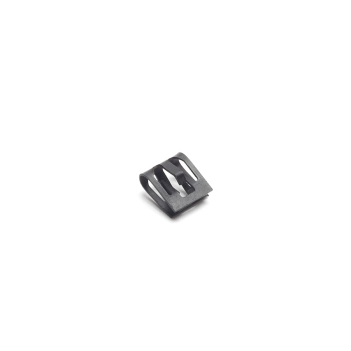

EYC106690 is this:
http://www.roversnorth.com/files/Images/large/EYC106690.jpg  1988 90 Td5 NAS soft top

That's the bad boy!

£2.64 each inc VAT from a LR dealer before any discount you can wangle Wink  1988 90 Td5 NAS soft top
