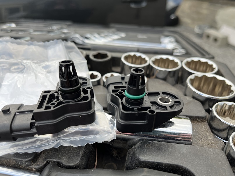

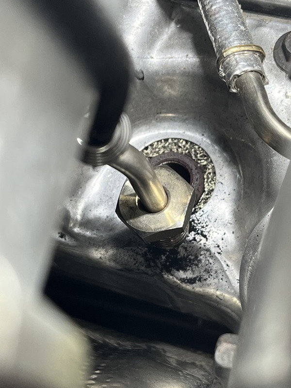

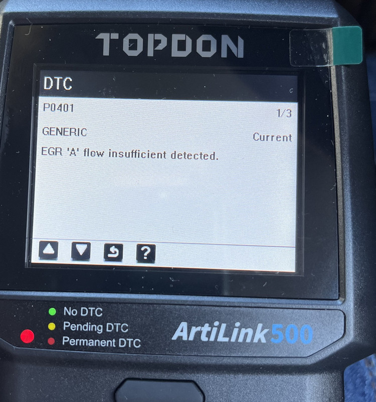

A big thanks to Retroanaconda for starting this thread, saved me a lot of time! This was also the problem with mine, here's some pictures to help others:
Symptoms I had: >P0401 EGR insufficient code that would return every 50 miles or so after clearing codes >Hesitation / stutter at around 1200rpm which was more noticeable when the engine was under load, almost like someone switched the engine off for a second >Little mid range power, very flat acceleration Fix >Clean out the metal pipe from the exhaust manifold to the exhaust pressure sensor Here's some pictures: Code on diagnostic: ![]() Click image to enlarge Pipe is located behind this boost pipe. ![]() Click image to enlarge I also replaced the MAP sensor which seem to bring back the mid range power however the low rev issue was still present and P0401 code. ![]() Click image to enlarge MAP part number ![]() Click image to enlarge This is the pipe and sensor ![]() Click image to enlarge Access is quite tight so I managed to clean the pipe by feeding wire up from the manifold side. You can see the dry carbon coming out. ![]() Click image to enlarge Over 600 miles done since without any engine light. Hopefully that helps others. |
