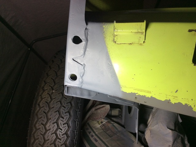

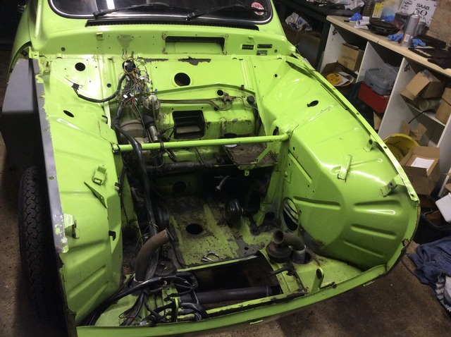

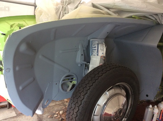

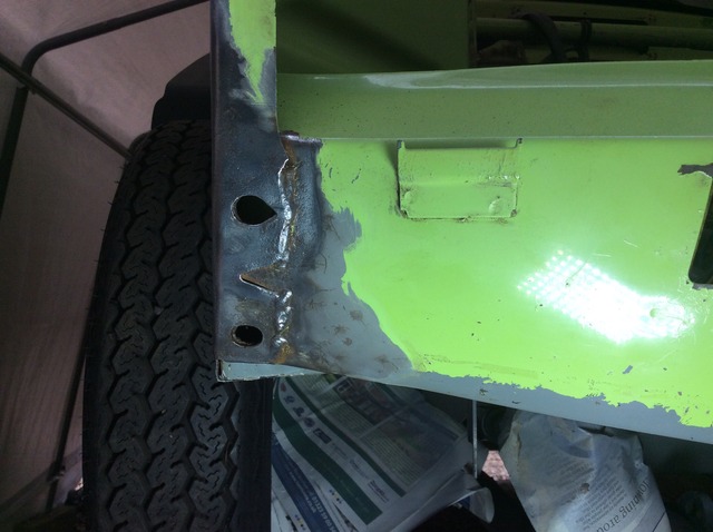

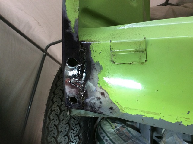

Currently working on this... Stripping out for an engine bay respray.
Dinitrol Converust, wear a proper mask with this stuff!
Primer.
Post #610507 19th Mar 2017 9:29am
