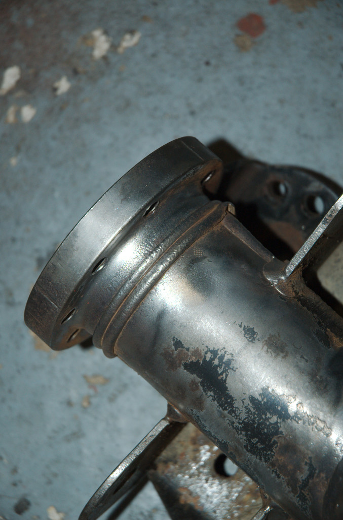

I recently picked up what was reportedly a 2010 Defender front axle casing from a breaker, which I cleaned up at the weekend with a wire brush:
prior to a solid painting job.
However, after purchasing this, I found out the problem with the Puma axle welds coming undone, as per the following thread:
https://www.defender2.net/forum/topic33029...;start=105
which is, well less than ideal. I am determining what to do.
I could get the two brackets, which are pretty costly (around £40 a side on ebay at the moment), and they seem like a pretty poor solution to the problem.
As I have the axle out on the bench at the moment I could run a TIG bead around the bottom side - I cannot reach the top side with the brackets in place, but the weight of the vehicle is causing them to tear at the bottom anyway.
Without grinding the lip off though and grinding a V into the casing, I don't think its going to have that much penetration, so I am questioning the benefit of doing it. I don't really want to grind into what could be a perfectly good weld if I can help it, especially as I don't have bullet proof confidence in my TIG welding ability at the moment for something as safety critical as this, having only been welding for 9 months or so so far. I would be happy just running a bead over the top of the lip though, which I guess would be better than nothing.

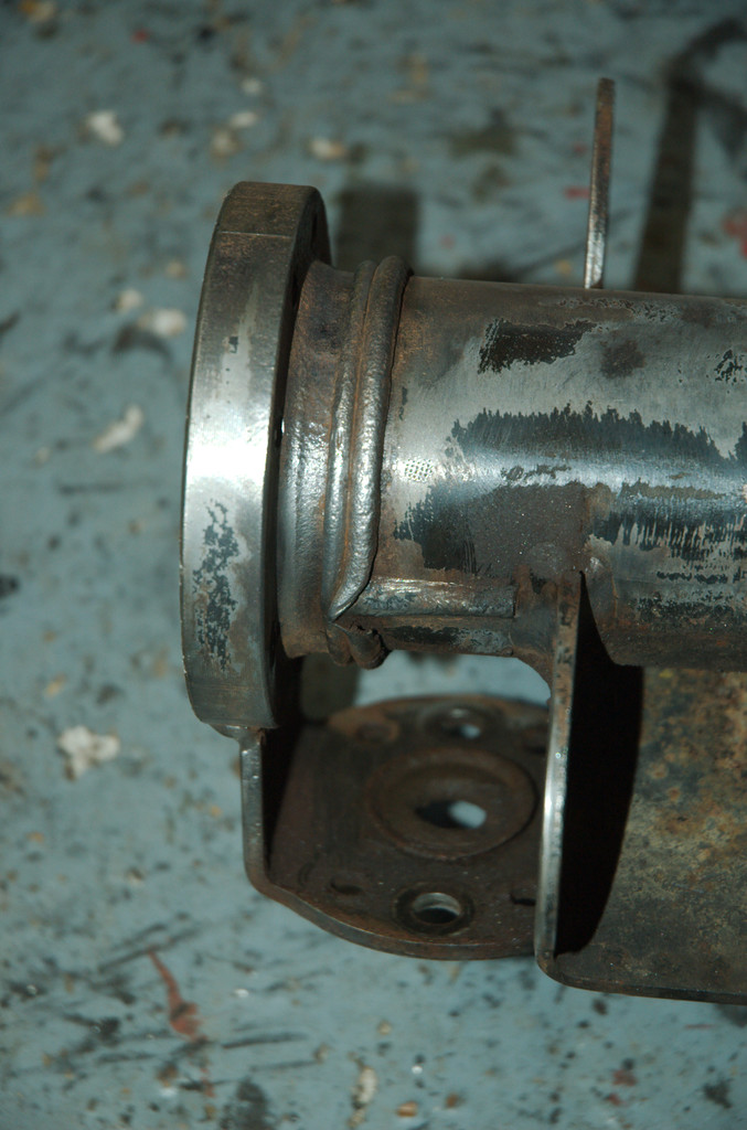

How do we think Land Rover (or their supplier) welded these in the first place? Are they just friction welded, which causes the lip to form? If it was friction welded, what's with the funny lip around the horizontal weld at the bottom of this picture?

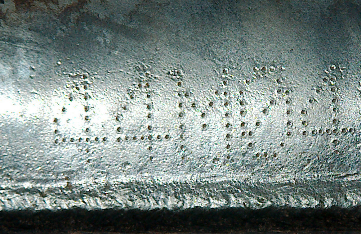

Finally, I could just ignore it and pretend the problem does not exist - after all it appears to be only been a very small number of axles which have failed. To that end, I tried to work out which Defender model this axle actually came from. Here's the start of the serial number:
which makes it a '44M' type. This is a problem - according to the web, there is no such '44M' axle serial number as listed on the following pages:
https://www.lrworkshop.com/axles-differentials/axlecodes
https://www.lrfaq.org/FAQ.3.EngineDrivetrainDataTransfer.html
There is a 44L (from a Range Rover), and a 44S (90" rear axle HD).

If it was mine I would cut off the spring perch, weld the axle end properly, then replace the perch. Depending on my intended use I would possibly reinforce the casing across the width of the axle, military style.
I don't want my axle failing, to the extent that I have the catch brackets fitted even though my vehicle is well outside the affected batch (at least one failure on this forum is also well outside this range, and I don't really trust JLR on this).
Incidentally I don't think either of those web pages are complete or accurate (there is at least one glaring error on the LRW page) and I think the fact you have a 44M axle proves that they exist.

If you're a competent welder go for strengthening the axle. I've done the same as blackwolf and put the brackets onto my axle. When I bought mine they were around £25 each so not too much.

I would definitely put the brackets on as the others have said .
My axle failed last year and it was a very unpleasant experience ! The axle didn’t have a double lip, like your pics, it was a single seam and it had clearly failed.
The replacement axle I purchased was from a 2012 and has the double seam like yours . I don’t know if that’s relevant ! https://www.instagram.com/hustynminepark/

Thank you for the replies gentlemen.
I think I am leaning towards running a bead over the top of the existing seem, and then shelling out for the 'catch' brackets as additional insurance then. Off to ebay I go Smile 2005 Td5 90 XS

Bo you no the age of land rover your replacement axles from Question

It was advertised as a 2010 Defender front axle. It arrived with "Defender" painted on the axle (presumably by the breaker), so I've no reason to believe it wasn't from a Defender.
Its also in pretty good condition with minimal rust (certainly much better than my 1989 one which is will replace!), so I can believe its a 2010 vintage.
I just hope it isn't one which was swapped by Land Rover as part of the recall, and ended up being sold on to a breaker... 2005 Td5 90 XS
