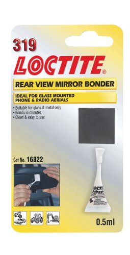

My rear window doesn't/didn't have a brake light.
I got hold of the proper LR light (huge great thing!) and the two threaded bits as above.
Used the "rear view mirror" fitting kit from my local autofactors (you get a little piece of mesh which you cut to size, then cover with the glue stuff and hold it on to the glass)
This:
Seems to hold ok for a while, then one of them falls off. I've tried it several times, then switched to tiger seal panel adhesive, that didn't work, then got my die grinder and "roughed up" the glass where the adhesive would be, and they still fell off eventually.
so now the 3rd brake light is in the garage... must advertise it on here sometime! eventually I'll find a slimline LED light to fit up there.
Don't know how they glue those threaded pieces on at the factory; must be a helluva adhesive.
Just a guess but probably a correct one that they use a UV curing adhesive as in Permabond. UV adhesives are not really for the home user but kits including a small UV light source are available commercially.
One tip though, make sure both the metal stud and glass are spotlessly clean the tiniest bit of grease even from a finger mark will cause the joint to fail. For those who like Welsh Mountains and narrow boats have a look at my videos and photos at..
