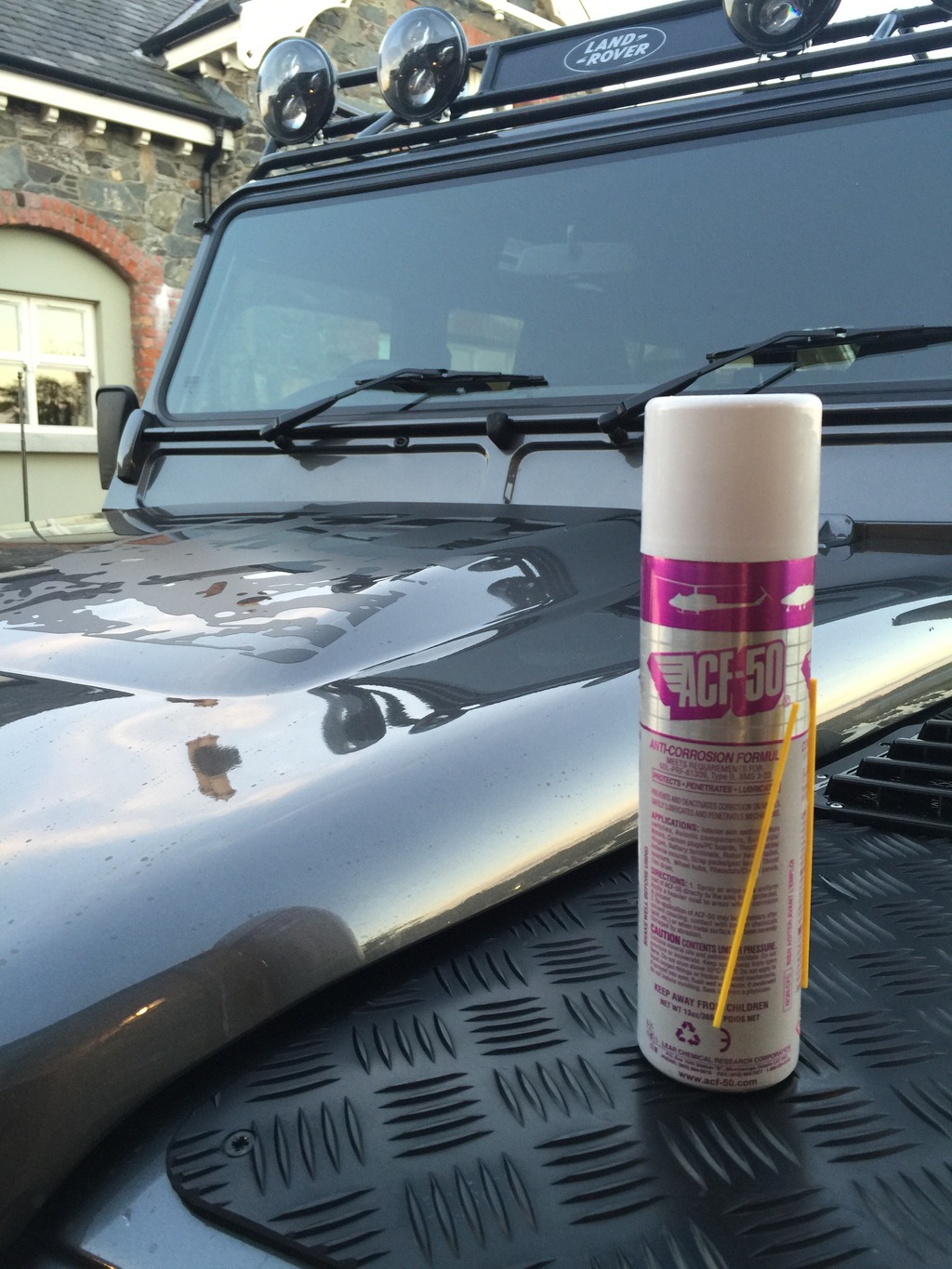

PS and don't forget the ACF 50 if you're preparing for the inclement weather - and in my case, I won't forget Captain Tolleys finest!

mcma1
Location: Northern Ireland
Posts: 2947
6 tins arrived yesterday!
As I am over in NI we don't have the option to be able to drive to the number of great companies as you can so we have to get our hands dirty.. Smile that's why this forum is so good as help and advice is always to hand.
Will give flat dog a call this morning. I was crawling under the truck a lot recently running some cables and to be honest it's like new just the usual surface rust on the arm joints etc which I can tidy up. Really think I will have a go at this myself as I can take my time and use my van in the meantime.

ACF50 Thumbs Up Thumbs Up Thumbs Up Thumbs Up Thumbs Up Thumbs Up
Absolutely have a go at the underbody protection yourself!
There's plenty of advice and guidance on this Forum and on t'internet. Wink Bow down
If you take your me you'll do the best possible job, and you'll identify any issues and familiarise yourself with our truck - getting intimate! Embarassed
There are many, many jobs you can and should do yourself.
I am quite averse to spending money unnecessarily, however I thought the aforementioned costs associated with a 3rd party getting dirty, banging their head, and having to clean up, we're quite modest. That is, if you haven't got the time or are physically unable to do the work yourself. Thumbs Up
