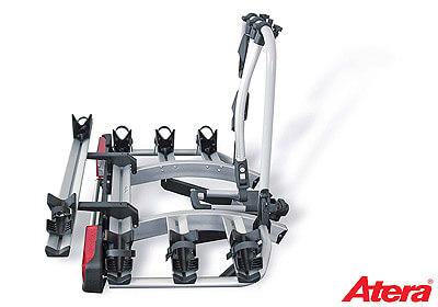

It is a Atera Strada Evo
It is 3 or 4 bikes (I have the fourth bike adapter, which somehow fixes to the back of the rack, but it's still in the box)

Nice andy
The Atera Strada racks are good pieces of kit
I too have the 4th bike adaptor - its bolts on although mine is old having being purchased some 5 years ago
The Atera rack will slide out and tilt allowing full opening of the Defender door, even with 4 bikes on it
Pick of mine below
Post #418780 24th Apr 2015 8:57pm

Ok. I like the rack and having trawled the forum I still have a question as not sure this would fit my 90.
I have the NAS step and the dealer added a 30mm spacer as I said I wanted to carry bikes and this would clear the spare. So would this rack fit on and clear it or is the tow bar going to need extending even further as per other threads?

mikeh - this bike rack will not fit your towball at present - even with the spacer the dealer told you to fit.
Other racks may be different, but with the Atera virtually the whole ball needs to protrude beyond the outermost edge of your wheel.

I had the Atera Strada on my X-Tech with the factory NAS step and standard tow ball. It worked just, but to click it back after being extended I had to push the rack back at the base so the upright could flex as it touched the spare wheel. Worked fine. The spacer should give just enough extra gap.
Now, just one word of caution. The factory NAS step is different to the genuine LR dealer fit one (look at pics, the x-tech NAS step doesn't go to the edge of the crossmember, the LR dealer fit one does). Not sure if the factory one I had is deeper than yours.

Mine is a factory NAS step but the wheel on the back is deeper and is probably on the extended/deeper wheel 'holder'
The best way to check if this carrier works is to hold a straight edge down the outside of your wheel. Your whole tow ball must go past the straight edge /end of wheel
