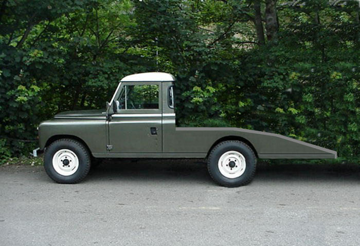

You need an Eezion Landrover - perfect solution but sadly nearly as rare as hens' teeth.
Had to look that one up:
Maybe he'd get away with this:
Post #329079 7th May 2014 6:09pm
Posts: 17815
I thought it might send a few people off to Google!
Here's an 80"-based Eezion:
