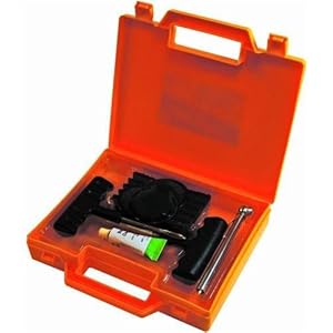

Tubeless tires are just as repairable as tubed tires- just get a quick repair kit like this:
http://www.amazon.co.uk/Silverline-Tyre-Re...B001QUN9UQ
and then find a place that does the mushrooms, or even get a mushroom kit for when you have a maint day.
