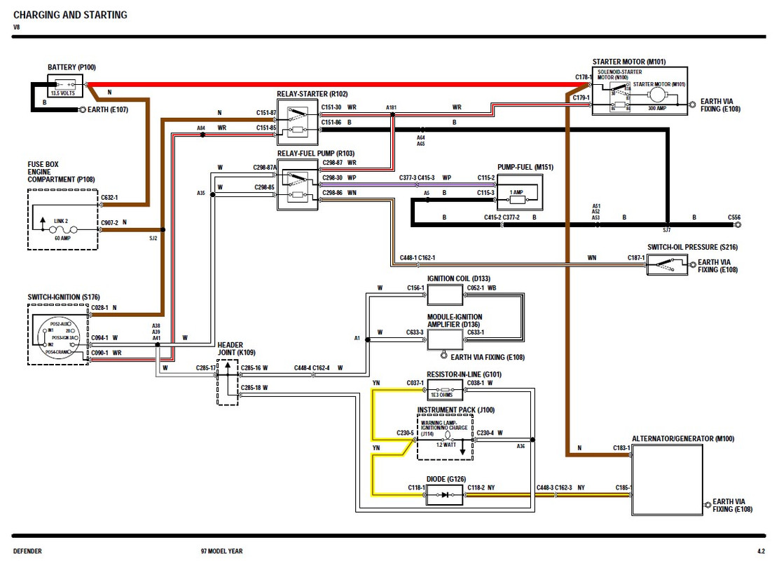

This is how the fuel pump is wired in a factory V8 of 300Tdi vintage -
I've copied this circuit diagram for harnesses that I've made for 200Tdi / 300Tdi to V8 conversions.
. Paul.

I have also taken it from the white feed.
Thank you. Cheers
