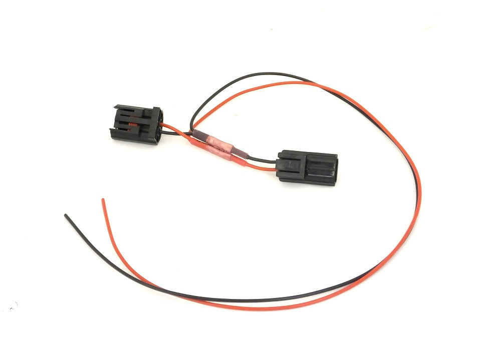

The Mudstuff piggy back loom would make this easy to connect -
https://www.mudstuff.co.uk/collections/wir...iring-loom
. Paul.
Post #1002439 31st Jul 2023 6:07pm
Jon_irving
Member Since: 18 Jul 2023
Posts: 7
The reverse camera piggy back connector from MUD worked great. I had one bought for another job. Wish I had just done it this way sooner, spent ages trying to find one in the cab!
