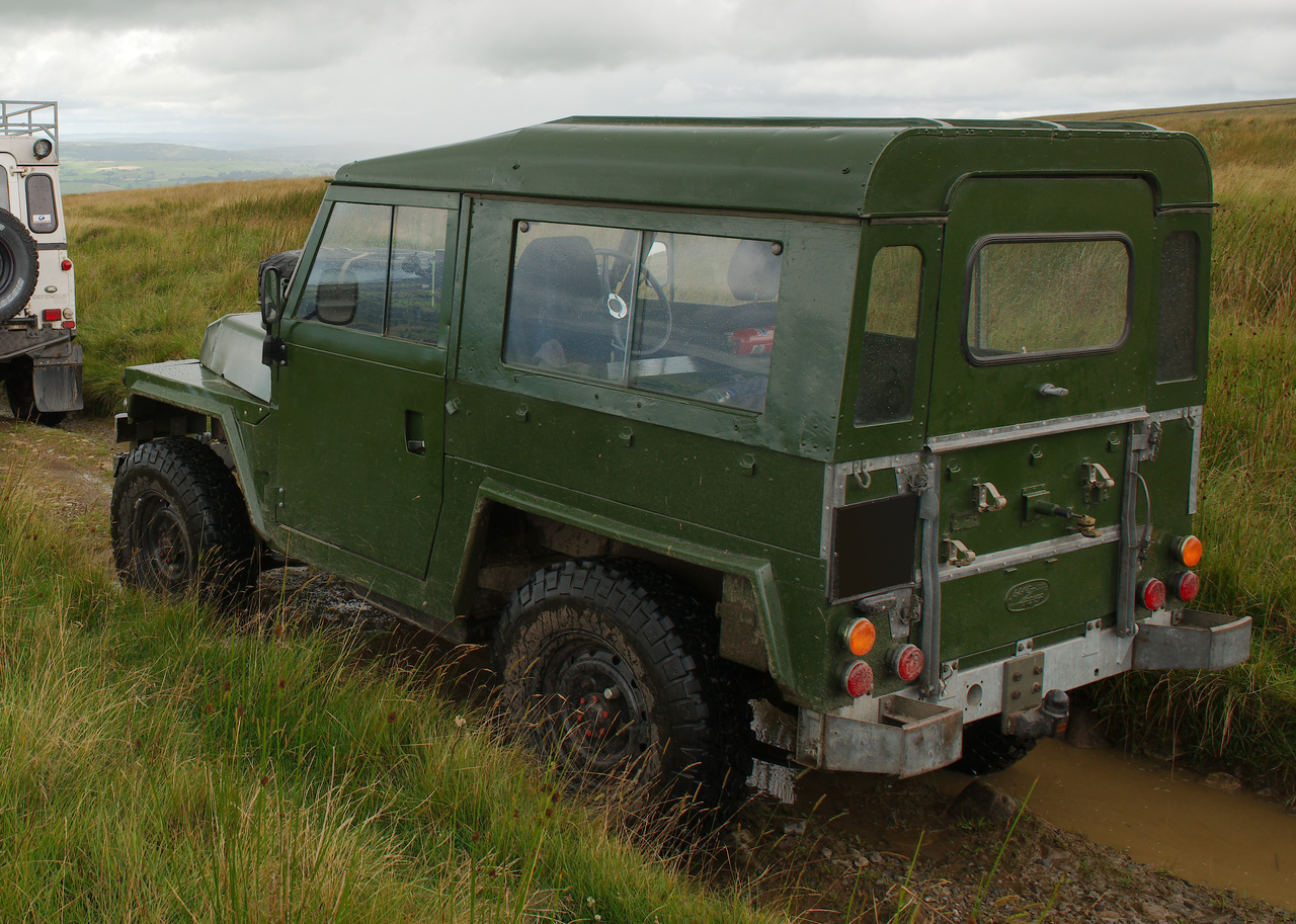

My Father has decided that his 2022 project will be to pull his 1971 series IIa lightweight to pieces which we have both shared for the last decade, and 'do it up properly' to make it a bit more presentable, while freshening up the engine which has developed an interesting creaky whine.
As part of this operation he would like to remove the plastic wheel arch extensions and get some new wheels/tyres which will fit without them:
We are struggling to find out what the original wheel fitment would have been for a lightweight, to have a narrow set of tyres on which would fit without the need for the arches. Does anyone happen to know what they would have been? Its on a set of modular type steelies at the moment, but with wider BFG KM2 tyres at the moment which will have to go.
It does have a disc brake conversion at all for corners so its possible a lower offset wheel might not fit around the brakes anyway. 2005 Td5 90 XS

It would have originally had 5x16 wheels.
Have the whole axles been replaced or just the hubs. If its got 90 axles, they will have a wider track.

I think the original fitment would have been 6.50 x 16 or 6.00 x 16.
If the disc conversion is an aftermarket one on the series axles it may not be possible to fit standard series swb rims as they will foul the calipers.
As far as I know only the Haystee conversion can use original rims.
I think you need to establish what axles and disc conversion you have first.

The tyres would have been 6.50x16 but not the wheels, they are 5x16

Its on proper lightweight axles, with the Zeus rear-disc brake conversion. I'm not sure which kit was used for the front discs.
Sorry Camelman I don't know its original military reg, I'm not sure if my Father has investigated that or not. I've seen both your green and red and white 1/2 tonners, looking mighty fine Very Happy
OK original wheels would have been 5x16 hmm that might explain why the current wheels stick out. Thanks for the information! 2005 Td5 90 XS

I'm running 1 ton rims on the green lightweight.
They are 6.50x16 ANR1534 but even with 7.50s, they only protrude slightly from the bodywork.
Sounds like your modulars have a more significant negative offset

Sorry, I was referring to tyre size, not rim size.
The current rims look like wolf rims.

The original tyres would almost certainly have been the legendary Goodyear Xtra-Grip in 6.50x16, the world's loudest tyre. You could hear them coming over half-a-mile away!
You could run 7.50 Michelin XZL on 5.50J16 rims as used on LWBs or standard steel Defender rims, they would not look inappropriate.

LWB rims won’t fit over Zeus disc conversions.
I run one ton rims on my series one and looked into fitting a disc conversion on the front. As far as I know the only conversion which will accept standard rims is the Hastee kit. On other conversions the calipers are too close to the rim.

Ah, I missed the rather significant point that the brakes had been altered. That greatly limits any originality options. I'd be inclined to convert them back to drums.

If you keep the existing wolf rims you could use a narrower tyre such as 7.50x16 Michelin xzl and it might just fit under the arches.

If you're just after a tidy up and a usable motor at the end of the day, leaving the discs on is probably the best option but will affect your wheel choice.
Decent Lightweight 2As are fetching good money and the more original the better. If you're going for a full on restoration, it would make sense to put it back to original drums.
