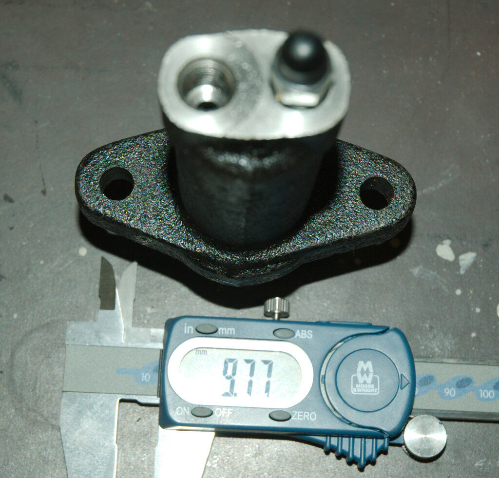

I pulled the slave out to inspect what the problem was, to discover that the thread was just smaller than the hole in the slave, and you can push the threads in all the way to to the bottom by hand if you get it square on (which was not obvious when it was attached to the gearbox).

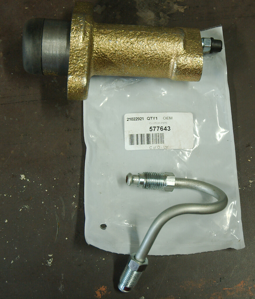

Well that's odd thinks I, but as this is a bit of a 'bitsza' (Rover v8 with R380 gearbox) maybe part 577643 (Pipe Jump Hose to Clutch Slave Cylinder Range Rover 90/110 VCool is not right for the Td5 style slave cylinder?

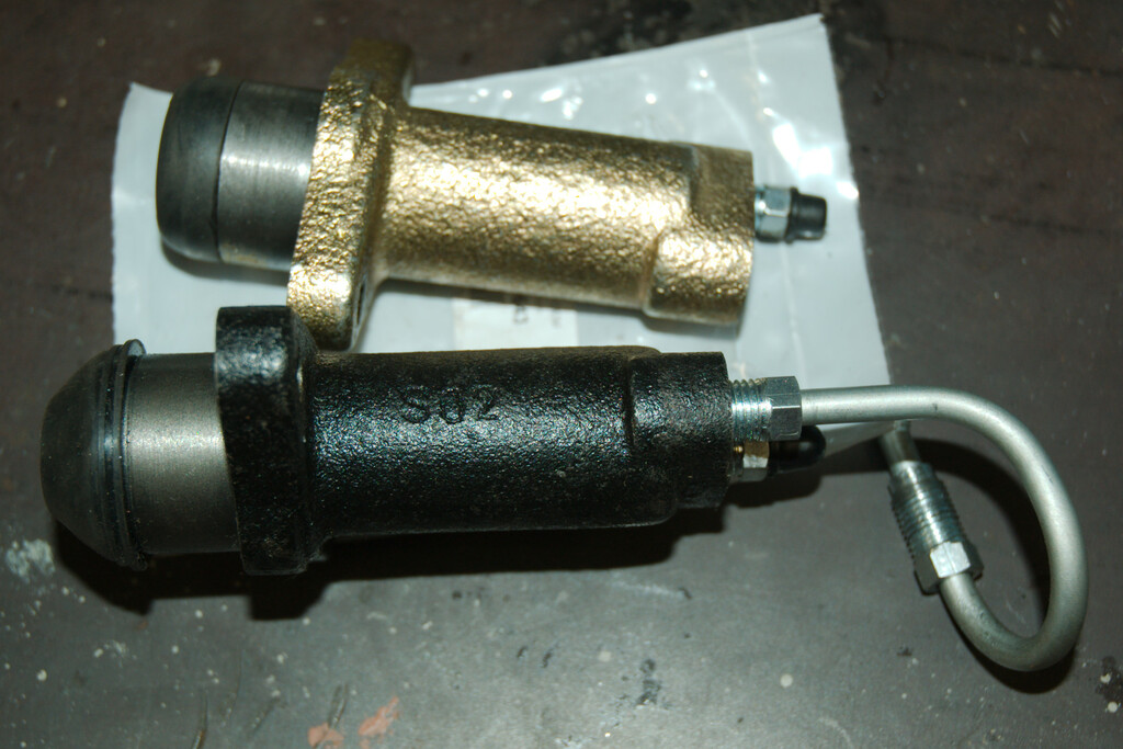

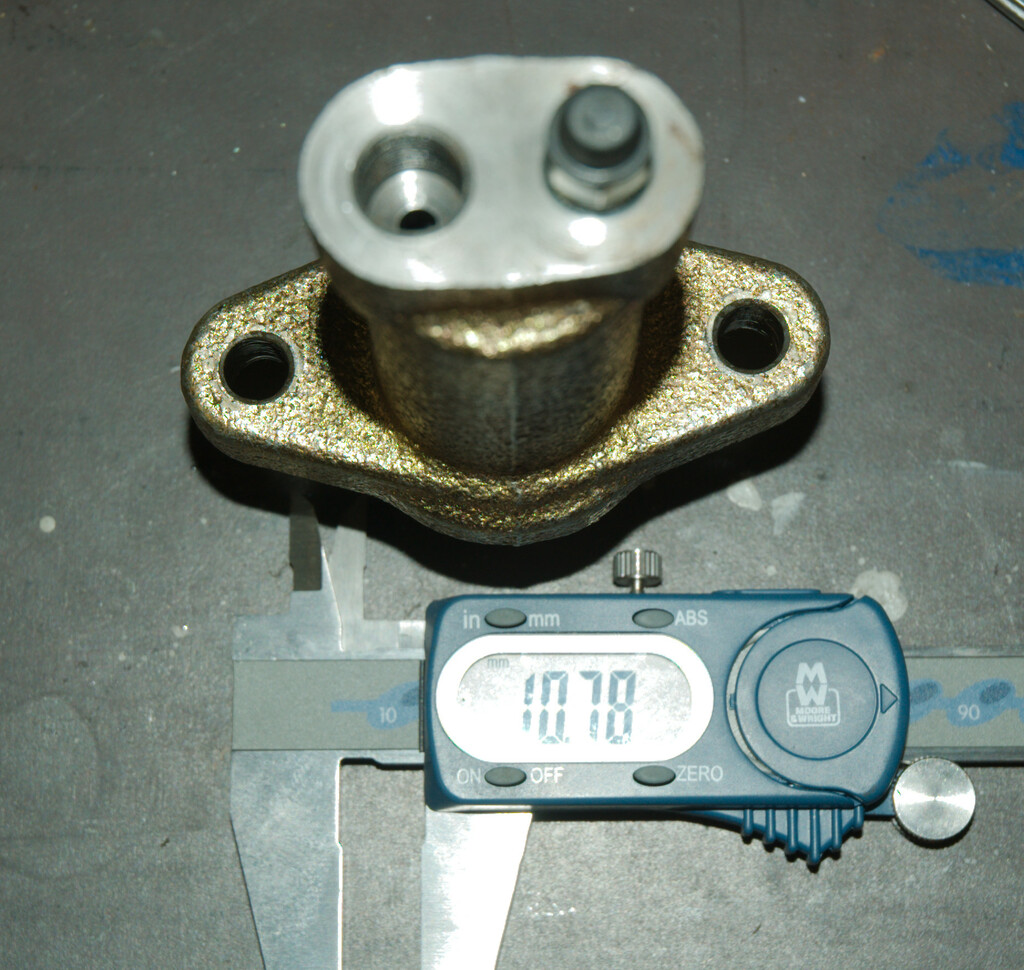

I then remembered that I had ordered two slave cylinders from LOF, the uprated 'POWERSlave' and a standard one to replace my td5 slave which I felt would probably benefit from being changed, having changed the leaking master cylinder a couple of years ago. As I haven't got around to fitting it yet, I routed about in the spare parts bin to find it - only to find that it has a smaller threaded hole which my union fitted!
Measuring the inner diameter of the threads confirms a 1mm difference.

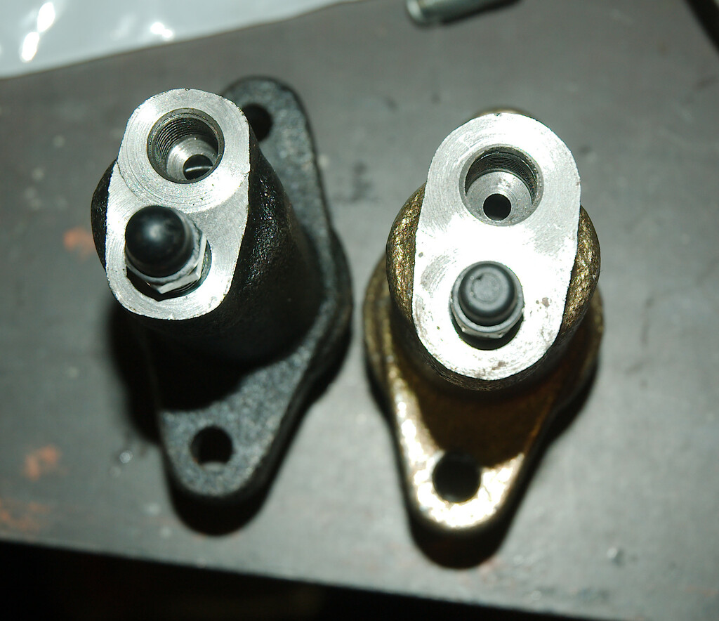

So what gives here? Is it common for these slave cylinders to use different thread patterns and bore sizes?

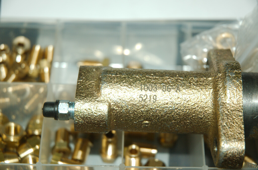

but nothing seems to fit this POWERSlave slave cylinder, which has the following part number stamped on the side:
1003-86-A 5219

It is conceivable that the powerslave has an imperial thread, 7/16 UNF would be about right based on your measurements and was used on clutch/brake fittings until the metric system was adopted by LR. I would have expected there to be a warning on the product page though given that most people will be fitting them to a 'metric' vehicle.
It's also conceivable that it was tapped with the wrong thread in the factory, since they will likely be producing slave cylinders with both thread forms. I'm sure Luke will sort it for you if you drop him a line. 1985 127 V8 Build Thread
