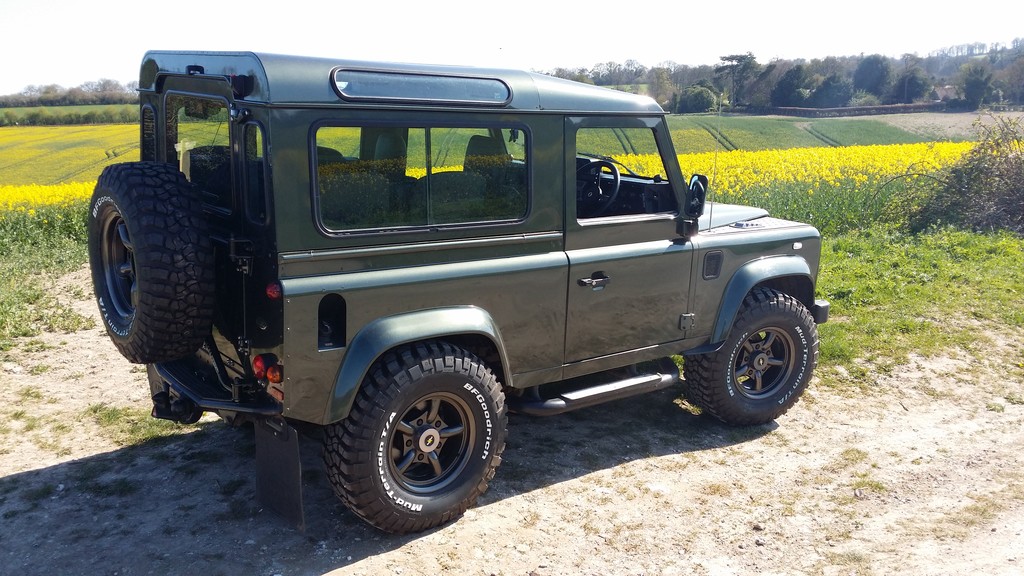

A pic of them fitted.

The issue you might have is if its pushing the boundaries for being out the arch too far.
For reference I'm running 285/75/R16 on my own 90, but on a +10 offset rim, and its pretty close to being inline with the arch, maybe 2-3mm inside, using the BFG KM2 tyre. Maybe you'll get away with it depending on which tyre you select. 2005 Td5 90 XS
That looks spot on Thumbs Up 110 DCPU

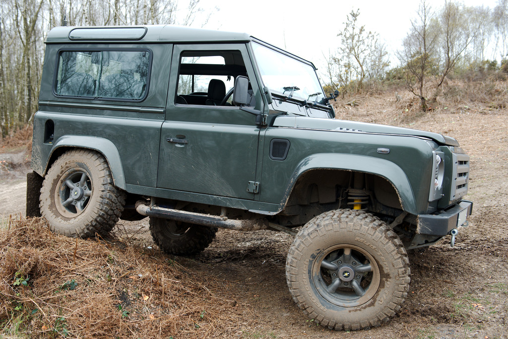

For reference, here is my 285/75/R16 on the original (possibly sagged) suspension, ET10:
It didn't rub on road, but as I also wanted to go off-piste, I added a 2" lift, where there has been no rubbing even at under articulation (although its pretty tight at the back).
