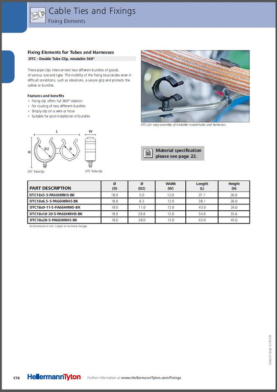

That type of pipe clip usually comes as two parts -
Your larger one is a 90° clip
Your smaller one is a straight clip
They're both available as male (stud) or female (socket).
You will need a male and female, straight and 90°, to clip together to make the clip you need.
Measure the diameters and see which of these suit -
https://www.comdir.co.uk/push-in-swivel-ca...aight.html
https://www.comdir.co.uk/pushin-swivel-cab...aight.html
https://www.comdir.co.uk/push-in-swivel-ca...0-deg.html
Hellermann-Tyton also make them -
Unfortunately, all of the above are in lots of 100 Sad
. Paul.

Paul - that’s amazing. Thank you: I’ll have a good google to see if I can find anyone selling in smaller quantities.

Cable ties it is: they don’t seem to be available in small quantities. Thanks again Paul - that was a head scratcher. I’ve just posted a clean thread to ask about cable routing and where the three clips are located/what they’re attached to so I can recreate the position with ties.
