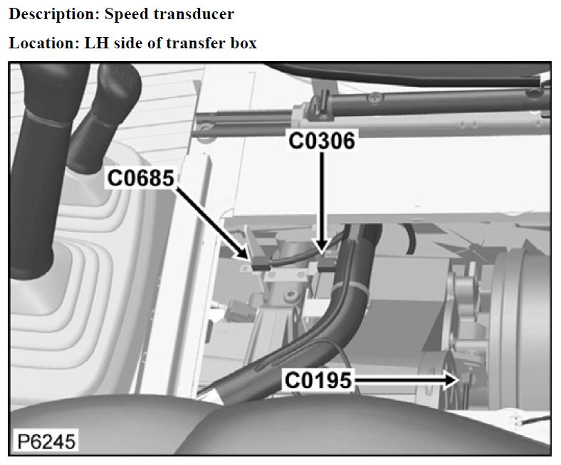

You can take the permanent live for your relay, from C0575 using an M5 eyelet -
You take the ignition-switched live to trigger the relay, from the speed transducer C0195 pin 1 -
C0195 is a 3-way female Econoseal connector - you can tap-off the ignition-switched live, using an inline male to female link, with a wire piggy-backed off of pin 1, to the relay in the fuse box compartment.
Something like this -
. Paul.

Thanks Paul. Just got around to doing this today and worked a treat. Your instructions were immense Thumbs Up Thumbs Up Thumbs Up

I’m going to follow this excellent solution too. I’m not too experienced in auto electrical so I’m wondering how I might go about neatly waterproofing the green/white 3-way splice? Any suggestions please.

@rockster57, I'm a bit late to one but did you get this to work and did you modify it in any way? I'm just about to embark on adding power to my seat heater relays but can't help but wonder if there's a better source for the relay trigger (ignition live) when there's a huge bunch of wires right there in the driver's seat box without having to delve underneath to the gearbox????
