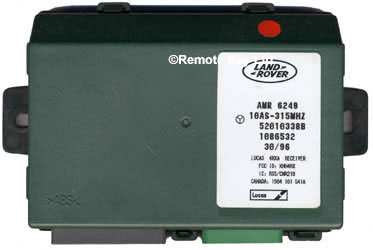

As most know, the Defender has been fitted with a 10AS Alam module / ECU manufactured by Lucas for many years, most noted by it's Green coloured Case. This continued to be fitted even although all other ECU's were replaced and migrated to CAN Bus technology
However it seems that a few years ago, the main Motorola Microcontroller used in the manufacture of the 10AS became obsolete and no longer available.
This was a big problem for JLR, as not only did they need new 10AS Modules to continue building new Defenders but they also had to supply dealers with as 10AS replacements where required.
This latter replacement provision requirement was likely why JLR did not just add a new Can Bus based Alarm etc, but commisioned someone, unlikely to be Lucas, to produce a replacement for the now unavailable 10AS. This replacement was named the ALM (Alarm Locking Module), and was designed to be pin for pin compatible, with the same connectors, and have the same main functionality, such that it could be used as a drop in replacement for a failed 10AS, without any major wiring loom changes.
It also has the same case, shape and style as the 10AS with of course the same mounting lugs. However the case colour of the ALM is no longer Green, but is Black. This close similarity to the 10AS has caused many to errantly refer to an ALM as a Black 10AS.
Land Rovers technical bulletin LTB00893, details repacing a 10AS with an ALM on Defenders that require a 10AS Alarm module to be replaced all the way back to 2007 MY vehicles.
Although I do still have a big question mark on this, as I somehow have an odd man out example, It seems that the ALM, even when retro fitted to replace a 10AS as per LTB00893 also uses an external RFR (Radio Frequency Receiver) and pebble shaped Plips, that is also fitted on all later Land Rovers. In fact SDD asks, with Pictures, which plip type you have to determine if a vehicle is fitted with a 10AS or ALM.
Diagnostically, the ALM does Mimic some of the 10AS Diagnostic access capabilities, but via fixing some technical access errors of the 10AS and having some removed and added functions, means the ALM has to be treated as a different ECU. Hence why no current equipment covers this ALM properly and even LR's own SDD has major problems.
Regardless of any other element or aspect, as a well known and respected first generation developer of diagnostic equipment I / We will continue our on going efforts to produce and add coverage of the ALM on our equipment.

There seems to be two versions of the black cased ALM ECU.
One that was fitted between 2012 - 2014 , serial numbers starting with CH, and uses the older style Lucas fobs.
One that was fitted from 2014 onwards. Serial numbers starting with DH, has newer fobs with chrome strip.
Apparently like the green AS10 unit before the first generation ALM ECU also became obsolete, hence then replaced with a different newer ALM ECU.
See details on remotekey’s site https://remotekey.co.uk/land-rover-keys-re...larm-ecus/
The question is, “does the nanocom unit support these two versions of the ALM unit in the same way? “ as reading your text in this set of posts you only mention the later ALM unit with new type fobs.
Remote key also state that you can have a problem with the ALM CH serial number versions if the main battery gets low. This can cause the software to be corrupted and they infer that if you try to reprogram with a diagnostic tool, I.e the nanocom, it will become unrepairable by them. Now I may have read this wrong, as the way they have written this is is slightly confusing. But it would be good to get your views on this as well.
