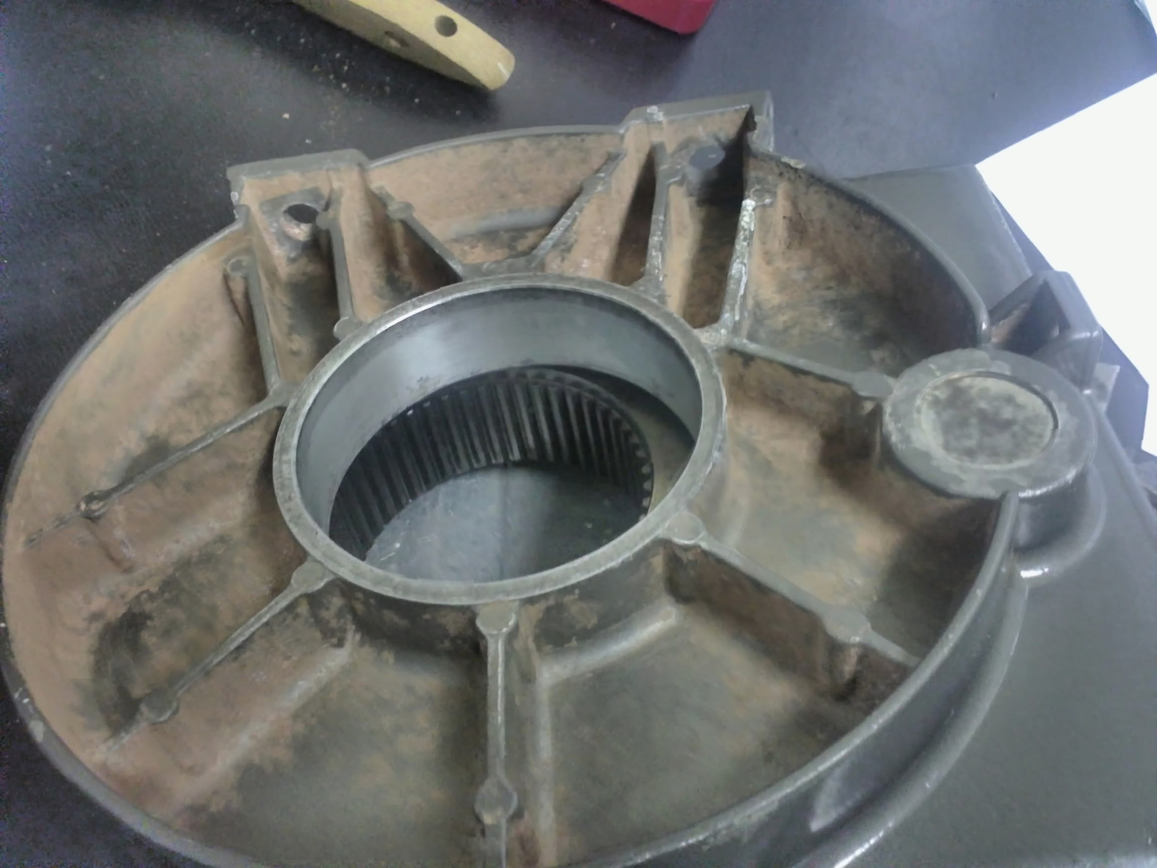

START:
-> As you can see, there is caked on mud which had cut into the paint surface and also destroyed the machined surfaces.
->All the grease used was of low quality and had turned into a rusty powder and was about as much use as a chocolate teapot!!
->The brake pads weren't greased and had seized onto the covers. The ball bearings were soo rusty they were were more like mini Ferero-Roche.
-> The motor was 80% motor and 20% dried clay
I started to think maybe I shouldn't bother, but I was going to change the motor anyway for a Bow2, and there were a few good points:
-> All the running gear was in great condition and no cracks or knocks to the aluminum housing Very Happy.
-> The electrics are all intact and even though caked in clay, it all worked Very Happy.

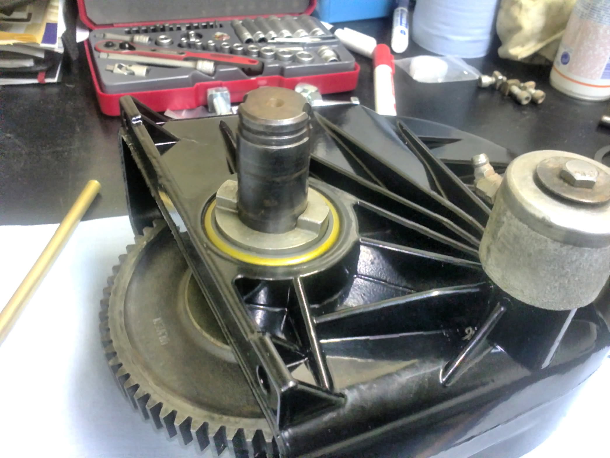

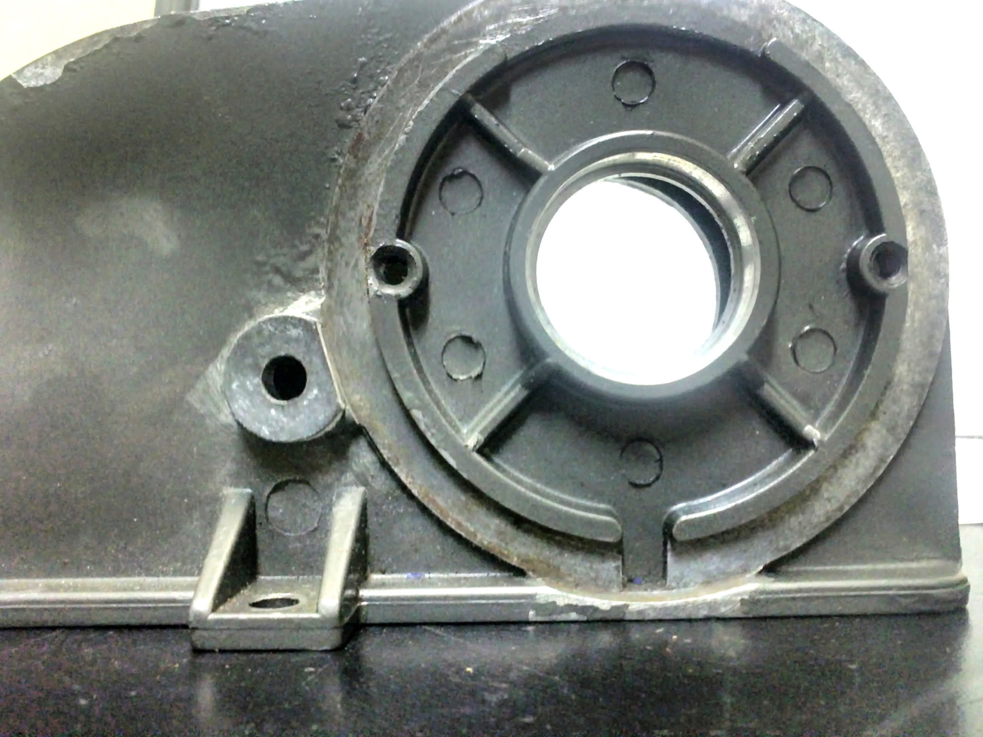

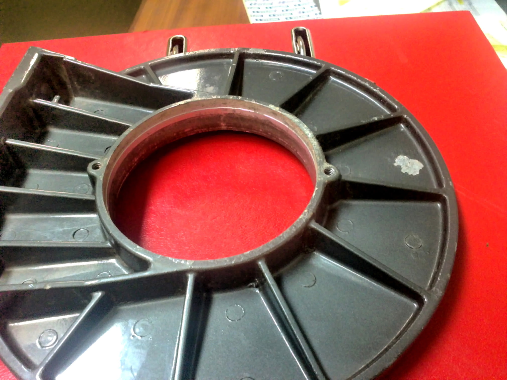

First off I stripped it sown to bare housing, had it sand blasted and powder coated in gloss black- this all cost £40 and the workmanship is as you would expect from German Engineering- it is a work of art.
On re assembly I decided to do a few little 'mods' to improve its reliability:
-> Gigglepin Top housing bush kit- This gets rid of the dodgy really fine roller bearings which were on their way out.
-> Gigglepin Brake pads and hardware kit- this was to replace all the corroded parts and the brake pads were used to improve the braking. As advised by top challengers, I have greases it all up with a top grade CV grease. All finished off with a aircraft grade cir-clip at the end so it doesn't go 'ping'- I may finish off and do a Gwyn Lewis mod to the end of it if I have any problems whilst testing.
-> All new bushes, gaskets and seals.... Why go to all this hassle and have a leak because I re-used a £5 seal!!
-> D44 end plate cover.
It is all coming together nicely..... Pics so far:
