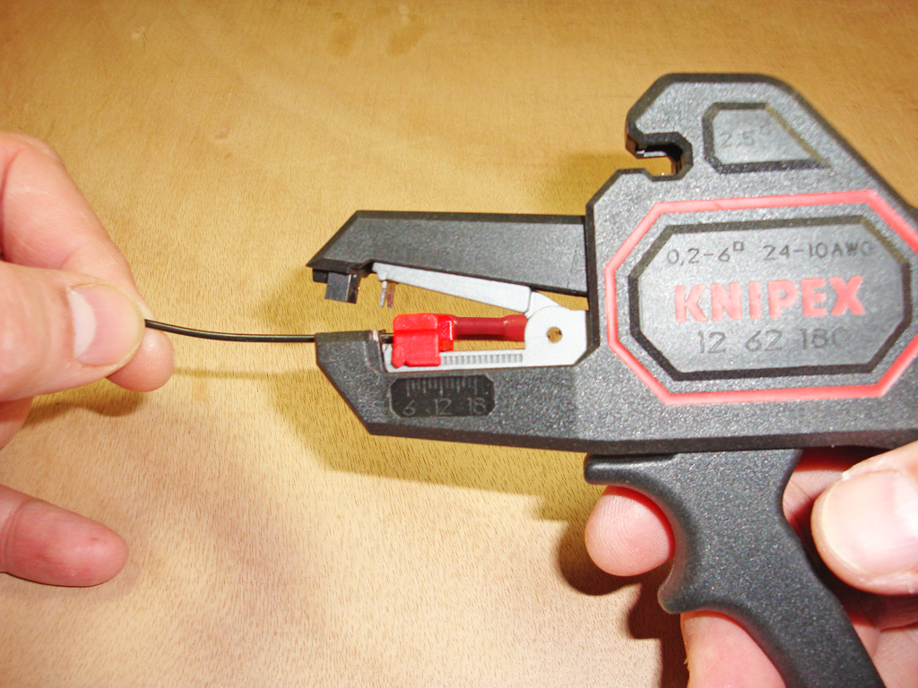

Adhesive-Lined Heatshrink Butt Connector and two cables �
Strip the ends of the cables to be joined �

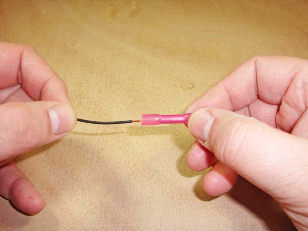

Insert the stripped cable ends into the Butt Connector from each side �

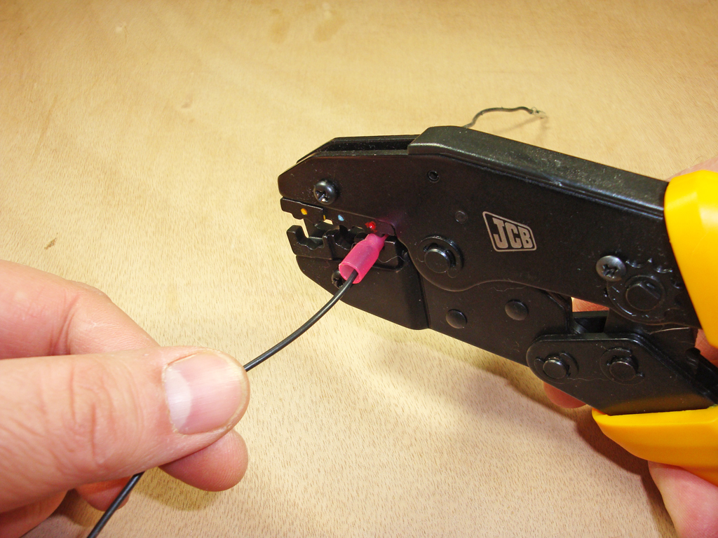

Crimp each cable into the Butt Connector using a suitable Crimping Tool �
Finished crimps �

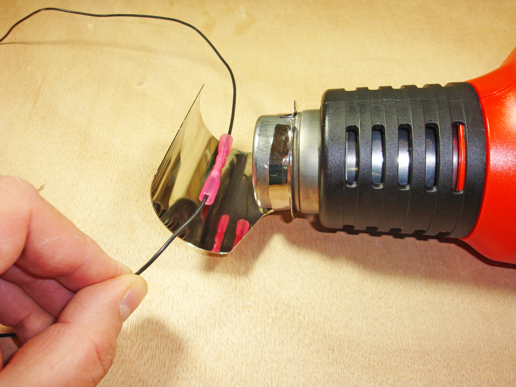

Heat the Heatshrink Sleeving until it�s shrunk and the Adhesive flows out �

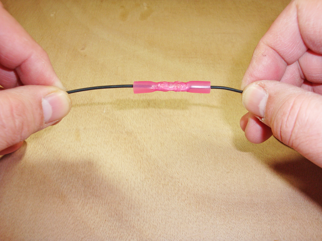

Finished joint �
