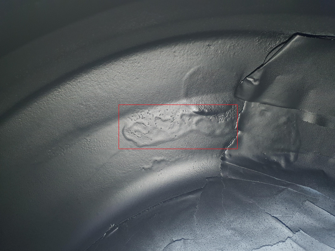

I applied Autotek Stoneguard over Etch Primer which was applied on clean bare metal. There appears to be what looks like crazing in a small area. I was just wondering what has caused this for future reference. It's the first time I've ever used spray paint. I allowed 24 hours for the Etch Primer to cure as per the instructions. Would you advise sanding it down with wet and dry sandpaper? If so, what grit would you recommend?

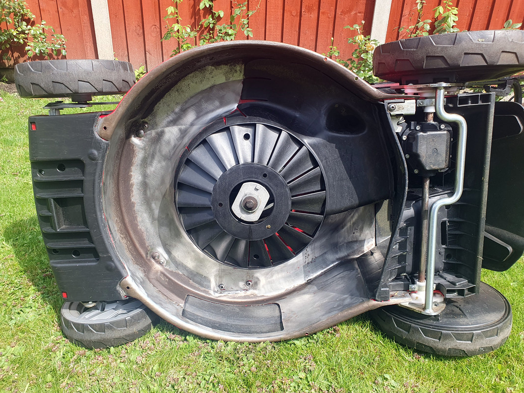

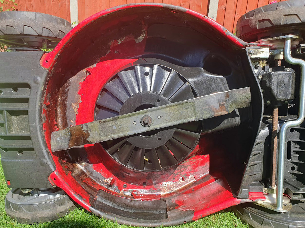

Finally finished this little project with the nice weather these past few days.
Start
Stripped to bare metal

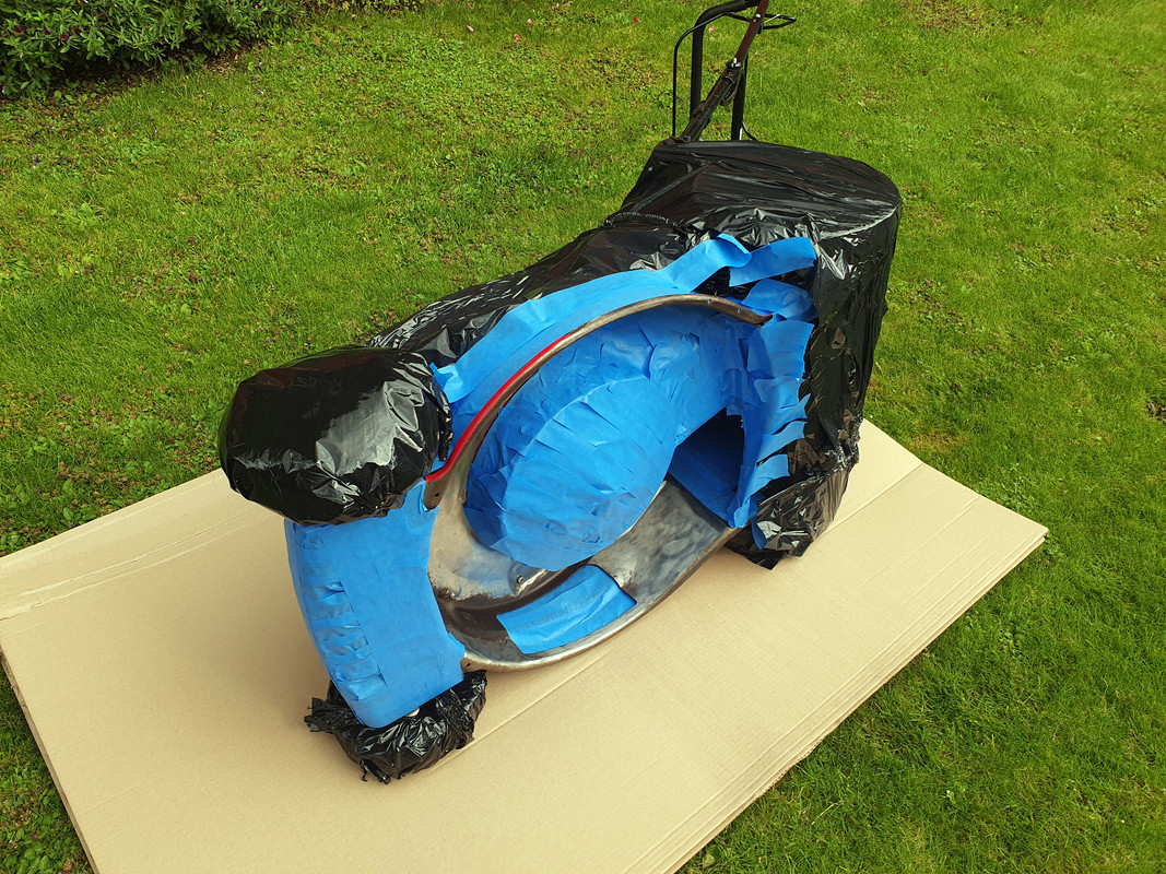

Masked up and ready to go

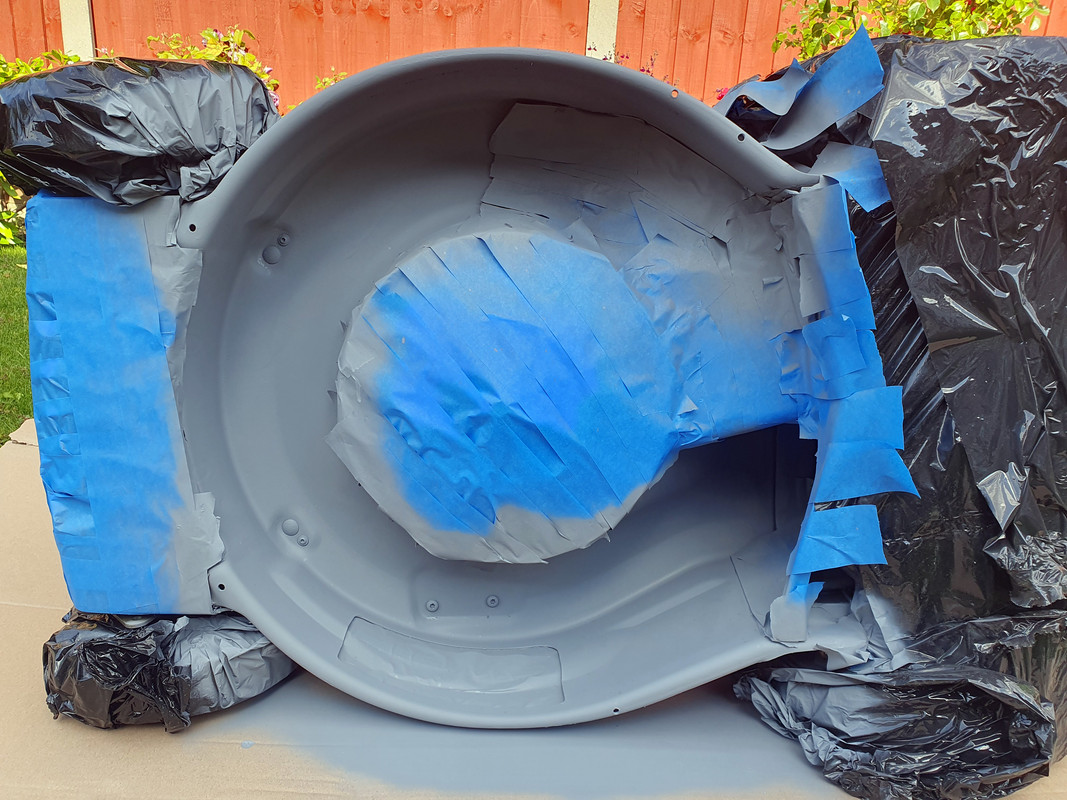

One coat of Autotek Etch Primer
Two coats of Autotek Stoneguard
