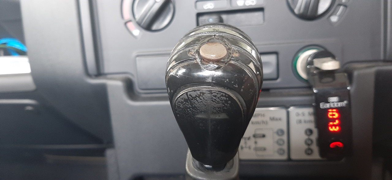

Here is my current 'situation'. Basically, rubbery thing is gone, so what is left is this very hard, shiny plastic thing, with bolt in center. Im wondering, is this bolt holding only plastic knob on the top or there is more to it, in case one want to have shiny stainless steel stick???
Post #897719 12th Apr 2021 3:20pm
Posts: 18033
I think the "bolt" is the top of the steel armature. Why do you think it is a bolt, as opposed to a plain steel shaft?
You will find that there are two (I think) holes cross-drilled through the shaft which I imagine are there to allow the polymer to bind more tightly to the shaft. Mine looked very like yours before I operated, and I do think that the £4 knob looks better that than the necrotic Landrover monstrosity!

I’m in the same situation as Ecco above.
My temporary fix is actually quite comfortable to use!
