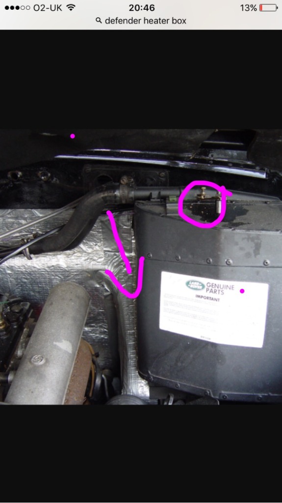

Hi folks. Up until today my td5's heater was fine.
Tonight I jumped in it and found the slider stick quite stiff to move from the 0 (off position) I wiggled it and it moved to 2 and there's nothing coming through to the cab.
I got out and you can hear the motor working but yet nothing coming through. I've checked the levers on the heater box and they move freely.
Any suggestions?
Thank you

I have highlighted the cable and arms I've checked

I have no help to offer I'm afraid, but what's that attached to your bulkhead? Looks line a sound liner?
It's not mine, just a picture i 'googled'

Mash wrote:
Is it drawing air through the intake?
Hi, yes, if i put my head to the wing air intake there's a lot of noise as if its sucking in lot of air.
I'm that frustrated by it i'm going to skive off work for 1/2 hour once it's daylight and go investigate, i think it could be a stuck lever.
Whilst i think i'm fairly mechanically minded, i've never had a Td5 and not had a defender for 7 years and that never had any issues.
Give me a mk3 escort and i can identify them part for part
