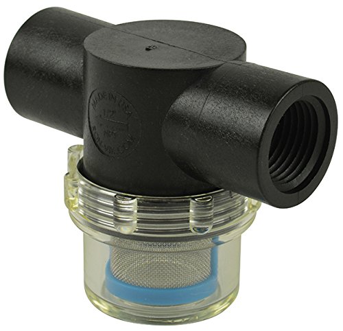

Not checked the piping but could you split it and insert a wire gauze filter - rather like the filter in an old 2.25. - it would capture most of the muck and keep it out of the egr mechanism?
