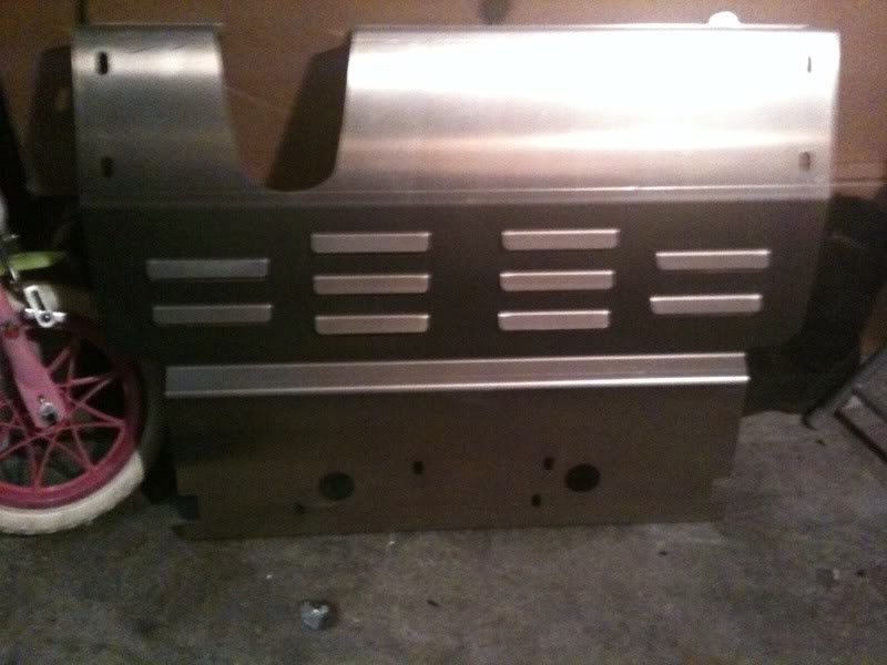

dgardel
Member Since: 30 Nov 2008
Posts: 3586
Italy
entreq plate on mine...
Admin note: this post has had its images recovered from a money grabbing photo hosting site and reinstated Mr. Green  Discovery 5 td6 HSE Stornoway Gray Outback Engineering Limited Edition
IID Pro MV License
Post #404679 5th Mar 2015 10:37am
x-isle
Member Since: 26 May 2011
Location: Midlands
Posts: 1327
I don't quite understand the Entreq plate.
It's supposed to protect both the oil filter and fuel cooler.
However, in that 2nd photo you can clearly see oil filter housing? So it looks like things can still be thrown up from the front wheels and hit the oil filter.
I've got the D44 fuel cooler guard and I'm going to make my own oil filter guard. Craig Rogers
