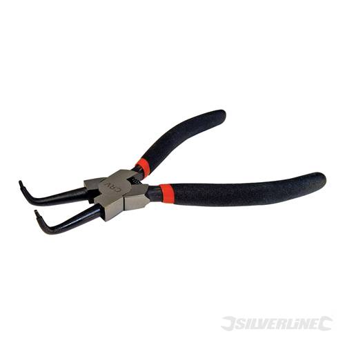

Yes lining out, its easy enough to remove the lining dependent on how 'stuck' the fasteners are.. A lot easier if you have a trim removal tool. Get a few spare lining fasteners before you start the job.
Even with a trim removal tool the fasteners are sometimes difficult to remove without damaging the head lining, I use a pair of these to get behind the head of the fastener to pull it out.
Or just snip the head off the fasteners that want to stay put. Once the lining is out you can easily remove the remainder of the 'stuck' fasteners. 130's have feeling's as well you know Smile
