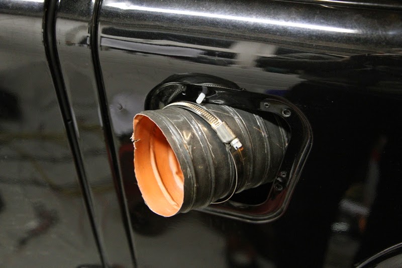

Finally got my intake installed Very Happy
Very pleased with the results.
90mm 2-ply silicone ducting (Rated to 325 degrees).

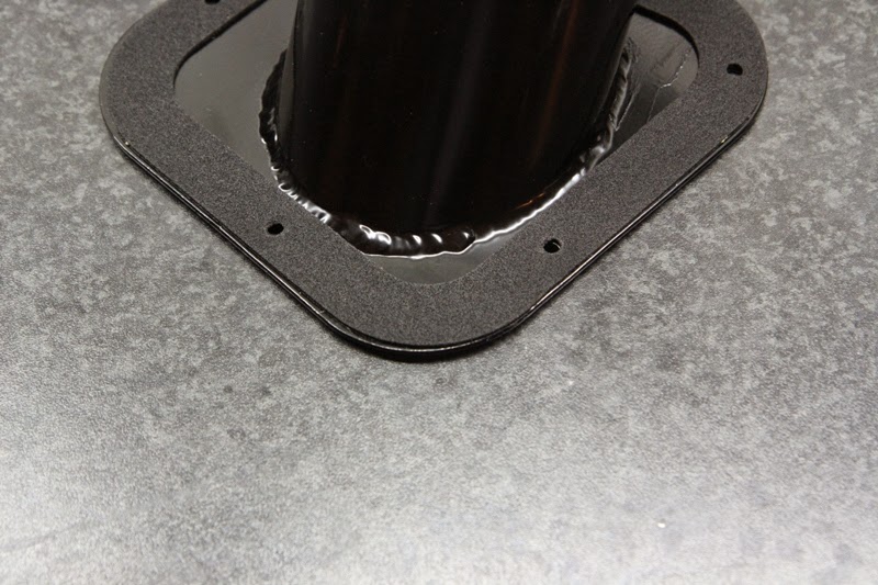

CNC cut adhesive gaskets:
Powder coated CNC'd aluminium plates and flange:
Flange being fitted:

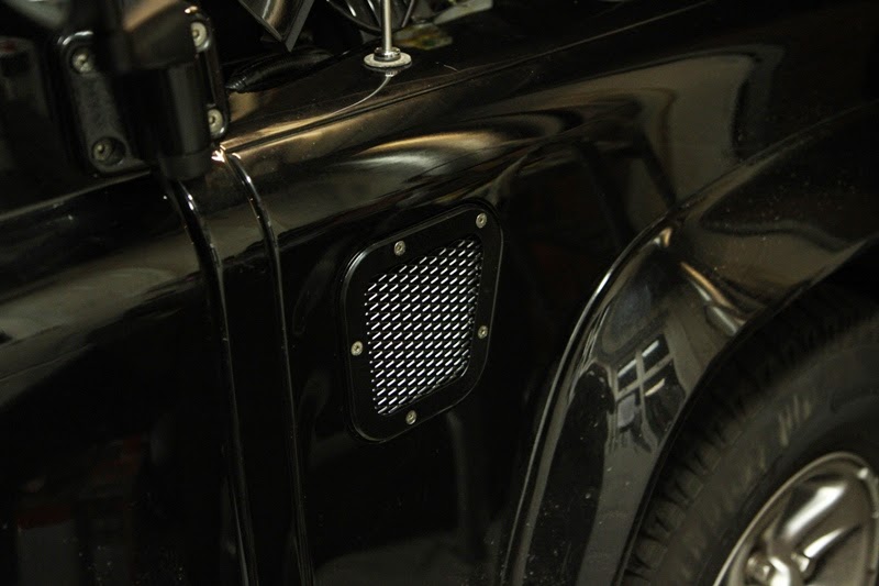

Outer grille fitted:
