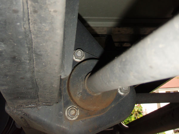

Here's an example of what needs to be tackled:
All surface rust but rust none-the-less and I don't like seeing it so would like to treat it. The coach builder chap who I spoke to last year said he'd Dinitrol it all and treat the rust but I didn't get the name of the product he mentioned about treatment, any ideas?

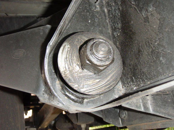

Lastly, I think I found evidence of Land Rover undercarriage treatment, it's pretty extensive! Is my Defender the only one of it's kind to have Land Rover under seal? Rolling Eyes
