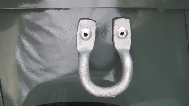

They are on mine. They are level with the canopy openings at the back.
They may not be on the new versions that have zip canopies!
I can take a pic in the morning if you want? 2006 Defender Double Cab- Zambezi Silver

Not got those galv hooks on mine - not even marks or holes where they could hae been Rolling Eyes

So what do the side ropes tie off to?

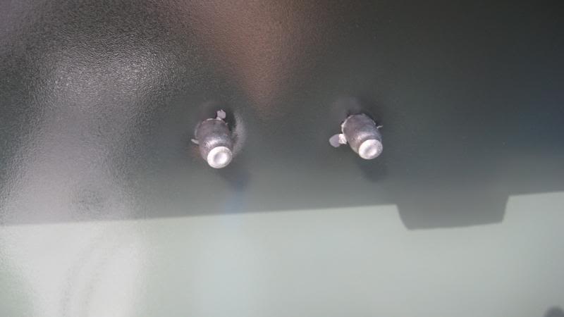

They are only pop riveted on - took off the plastic blanking cowls yesterday and was disappointed to see they hadn't even used a washer to spread the load a bit. If you wiggle the cleat there's quite a point loading at the fixing point. Will be drilling mine out and replacing with some small bolts and appropriate penny washers or spreader plate.
