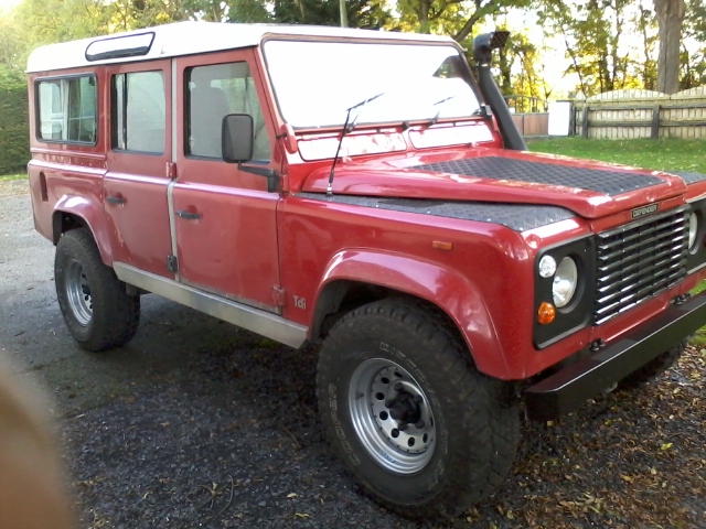

Nidge
Member Since: 27 Jan 2008
Location: Kildare Ireland
Posts: 831
Ireland 2009 Defender 110 Puma 2.4 HCPU Cairns Blue
Andrew I am currently running 285s on 16 x 8 Mod rim and sit just outside the arch...
Well to be honest in thru land rover fashion they protrude on one side and level on the other ! Whistle
N.
