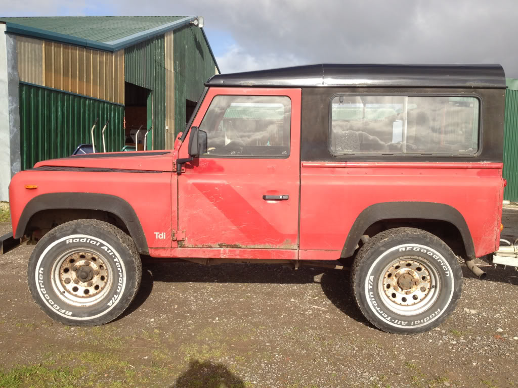

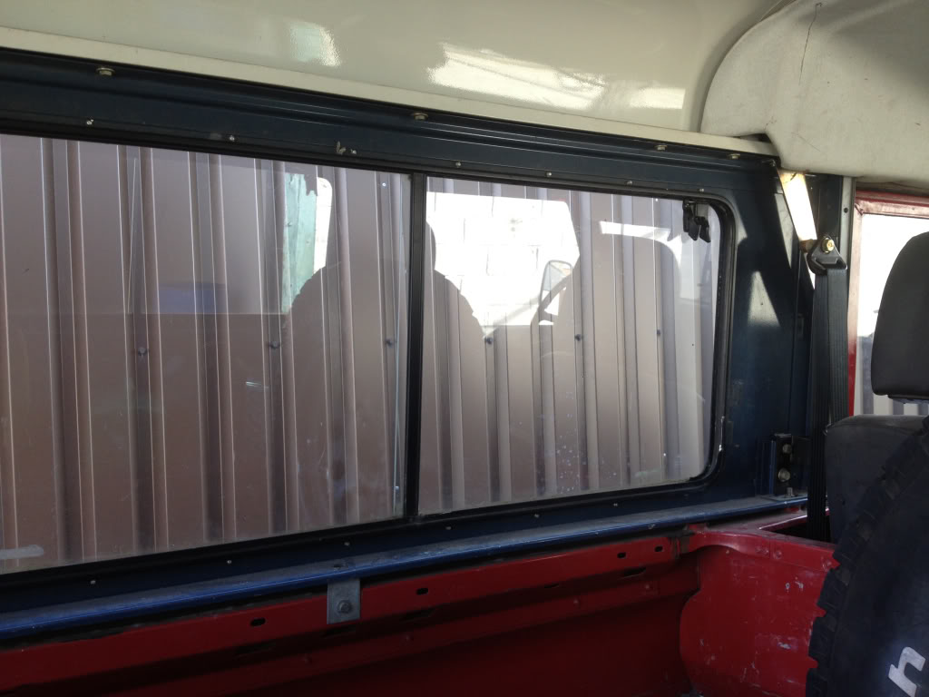

Ok got some pictures, just see if this works Neutral
This should be a side view of my defender

And this is the inside where I'd like to fit some trim if I can get it, around the window
https://s3-eu-west-2.amazonaws.com/i.hubnu...6e7cc4.jpg

Post #171807 29th Sep 2012 6:51pm

You can see the trim around the rear windows on my TD5 90, is this the sort of thing you are looking for ?

Member Since: 09 Oct 2011
Location: Hertfordshire
Posts: 6478
works perfect Very Happy now really its trial and error, the windows have been put in after but do look original and cut and fixed evenly so really your back to square one Rolling with laughter Rolling with laughter CSK Automotive

Bob Neville Very Happy Yup that's what I'm after Very Happy where did you get your please?

Killer 90, Ah Confused so they are standard window but because they're not factory fitted their's a chance they won't be aligned compared to the standard inside trim?

They are standard TD5 90 CSW trim.
Dan at Duckworths (site sponsor) will get you a good price on them Thumbs Up
Killer is right, if the windows are not standard then you may have fun getting them to fit.
Can you get some measurements from your 90 so I can compare to mine ?
1. Distance from the rear of the door opening to the frame - take from the flat of the frame - do not include the frame.
2. Outside front to outside back of the window, again on the flats but include the frame.
3. As 2 but top to bottom of the window.
4. Rear corner to the start of the frame (as in 1).
This will give us a good idea on where the windows are fitted and if standard trim will fit.
Bob
Bob got its spot on measurements Wink if they are out and trim want work you could consider the mud uk trim panels for a hardtop and you could cut the centers out to fit your windows Thumbs Up CSK Automotive
