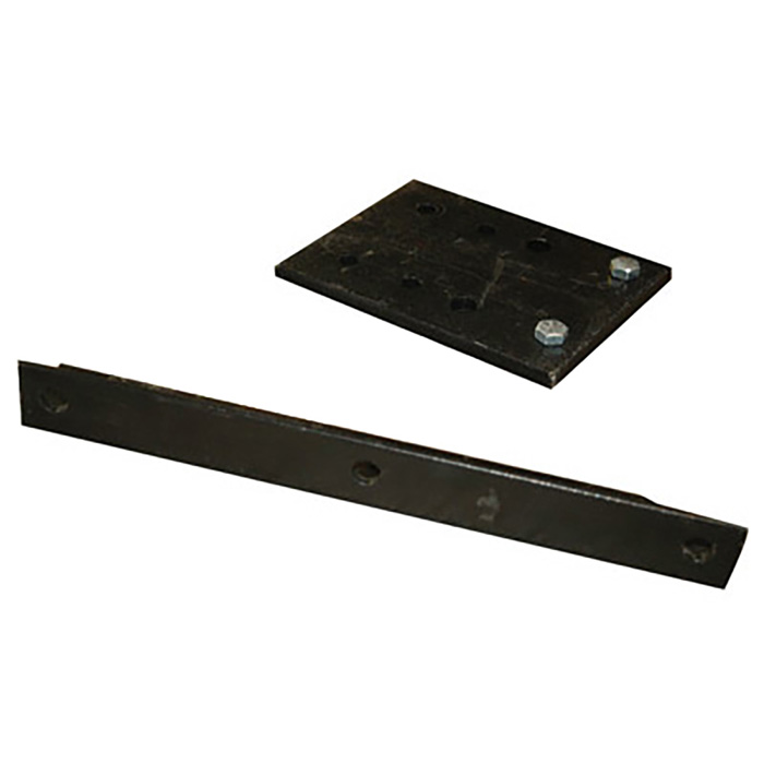

Correct. KNK500030 .
Available from £11 upwards. I.e https://www.ebay.co.uk/itm/303328882760?ep...Sw6-5drCxY

^^^ Not quite; that's the trailer breakaway attachment plate which was a modification for in service vehicles.
For the Td5/Puma defender LR say to use KNK100090K which is just a piece of angle iron that bolts under the crossmember (like the DB adjustable hitch has) and an extended version of the plate above that reaches down and is bolted to said angle iron.
Dead easy to make if you've got some thick steel kicking about.
