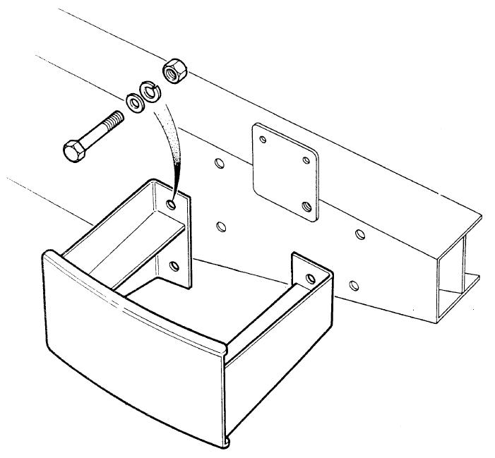

From your diagram -

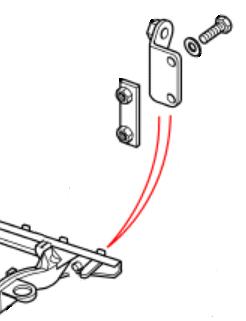

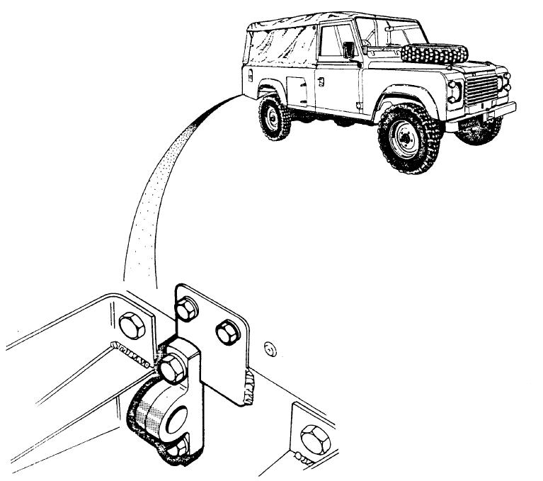

A B + H I, are for the civilian 'grab handle' rear bumperettes - ![]() C D + F G, are for the military rear bumperettes - ![]() Click image to enlarge E + one you've missed on the body mounting tab, are for the military lifting/lashing shackle mounting - ![]() Click image to enlarge J + K, are for the drop-down tailgate hinges - ![]() . Paul. 1989 Arles Blue 2.5TD 110 Hardtop 1999 Epsom Green Discovery II 4.0 V8i 'XS' Last edited by PaulMc on 6th Dec 2020 9:38pm. Edited 1 time in total |

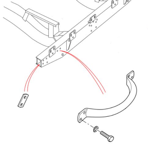

I meant to say that I don't know what L and M are for, as I don't have those on my pre-Tdi crossmember -
![]() Click image to enlarge . Paul. 1989 Arles Blue 2.5TD 110 Hardtop 1999 Epsom Green Discovery II 4.0 V8i 'XS' |
blackwolf Member Since: 03 Nov 2009 Location: South West England Posts: 18031 ![]() ![]() ![]() |
L and M aren't present on my Puma cross member either, although all the others are including the one you missed.
