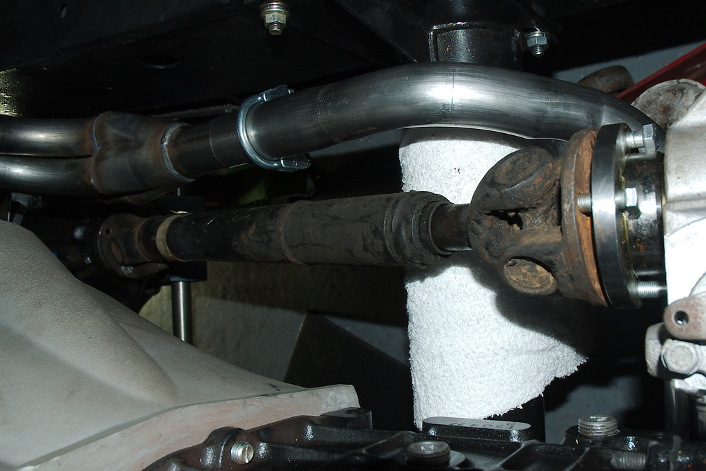

So far so good. However, the front is much more "interesting". The original propshaft is too short to bridge the gap between the axle and the transfer box:
which surprises me. I *think* that its fully extended, at least it smoothly opens up to that point then stops dead. Measuring the top the two flanges gives me a reading of around:
674mm, -8mm differential flange width, for a total of 666mm

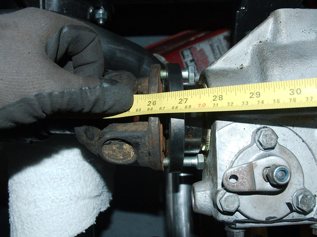

I had quite a bit of head-scratching on this, until I measured the distance the other way round, while lying under the vehicle, measuring the distance between the bottom of the flanges, where I found the measurement was much less, at:
644mm -11mm LT230 flange width = 633mm
which is now within the range of 300Tdi. Frankly I was amazed there is over 30mm difference between the upper and lower flange surfaces - but this does seem to be because the front diff is angled upwards, whereas the LT230 flange is pretty near the vertical.
If I take an average of these two, I *should* get the distance between the centres, which would be: 650mm
Taking into account the 2" lift, we are nearly within reach of the 300Tdi size. While I know we can get custom length props made up, I am puzzled as to why I'm not bang on standard distances. Am I being overly fussy?
