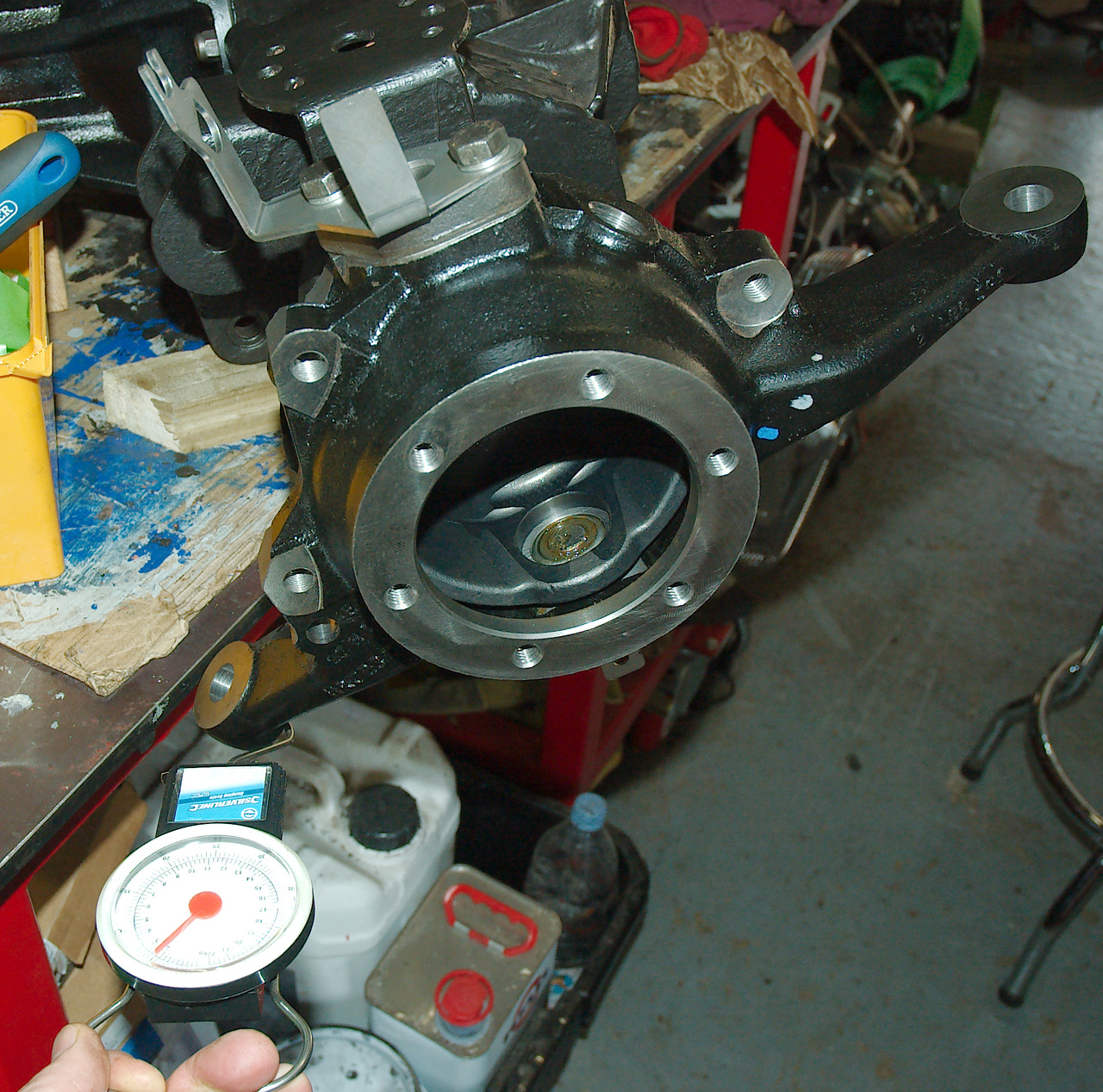

I'm rebuilding my front axle at the moment, and am setting the resistance on the swivel housing.
The Haynes manual states this should be between 3.6kg and 4.5kg of force needed to move it, when pulling off the rear tie rod bracket.
So I'm doing this:
I've got it to about the right resistance, in the 3 to 4kg range anyway, but this feels quite stiff to turn by hand. Have I misunderstood something, or should it be quite stiff to rotate? I've checked the pull gauge calibration with a known 5kg dumbbell weight, which it correctly measured.
I think I'm doing it right but would like a bit of confirmation from more experienced minds. My concern is that all the videos I've watched of people doing this, they seemed to use all the supplied shims (or even needing additional ones), whereas I removed 3 of the 4, leaving just the thickest 0.8mm shim left to get the right tension.
Please set my mind at ease!

Hi hufflepuff, your picture doesn't show it, but have you left the swivel seal unattached?
The resistance figures you've given are for the pull without the seal in place. Apologies if that's too obvious, but the same question was posed just a few weeks ago, and that time, the seal had been fitted.
I think there's more initial resistance, but then the quoted figures are for the 'steady pull / swivel moving' phase - even it if is quite a short range of movement. Donald

The seal is not fitted at the moment, as per trailer fitter Chris’ recommendation, the ball is just mounted to the axle with three bolts.
The workshop manual for the 300tdi is stating only 1.5kg if force then Dorsetsmith? I wonder why the Haynes manual is so different. I actually bought Brooklands dork shop manuals for both the older models and the td5 onwards, but I have not been able to locate the procedure for the swivels in them. I will go and have another look... 2005 Td5 90 XS

Ah the mystery deepens. In the workshop manual 1983-1995 MY, it states 3.6 to 4.5kg, the same as the Haynes manual. I wonder if Land Rover updated the procedure when they moved away from the Railko bush. 2005 Td5 90 XS

You are correct, the lower drag force should correspond to the use of the upper and lower taper roller bearings. The higher setting was for the Raiko bushing.
Be aware that one of the workshop manual gives a ridiculous torque setting for the lower swivel pin retaining bolts (which are only MCool. EDIT: It is infact step 45 in DorsetSmith's screenshot of the manual that specifies 78Nm for some M8 Gr8,8 bolts Rolling with laughter

I wonder if the ball joint bore it is stating to hand the spring balance off is the front, longer arm? The earlier manual was stating the rear shorter tie rod arm. It is possible that 3kg on the short one is the same as 1.5kg on the longer arm, I will go and measure.
Annoyingly the newer doc is stating the lower pin bolts should be 78nm. The older workshop manual states 22 to 28nm, which did not seem much at all. Pity I have lot items those in already, I will remove, clean and redo to the higher torque, and then just follow the newer manual’s instructions throughout. 2005 Td5 90 XS
