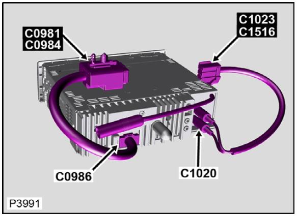

The Grey 4-way connector is C1516, which is the other end of the sub-woofer harness.
There's a link harness LR040847 to go from C1516 to the head unit -
. Paul.
