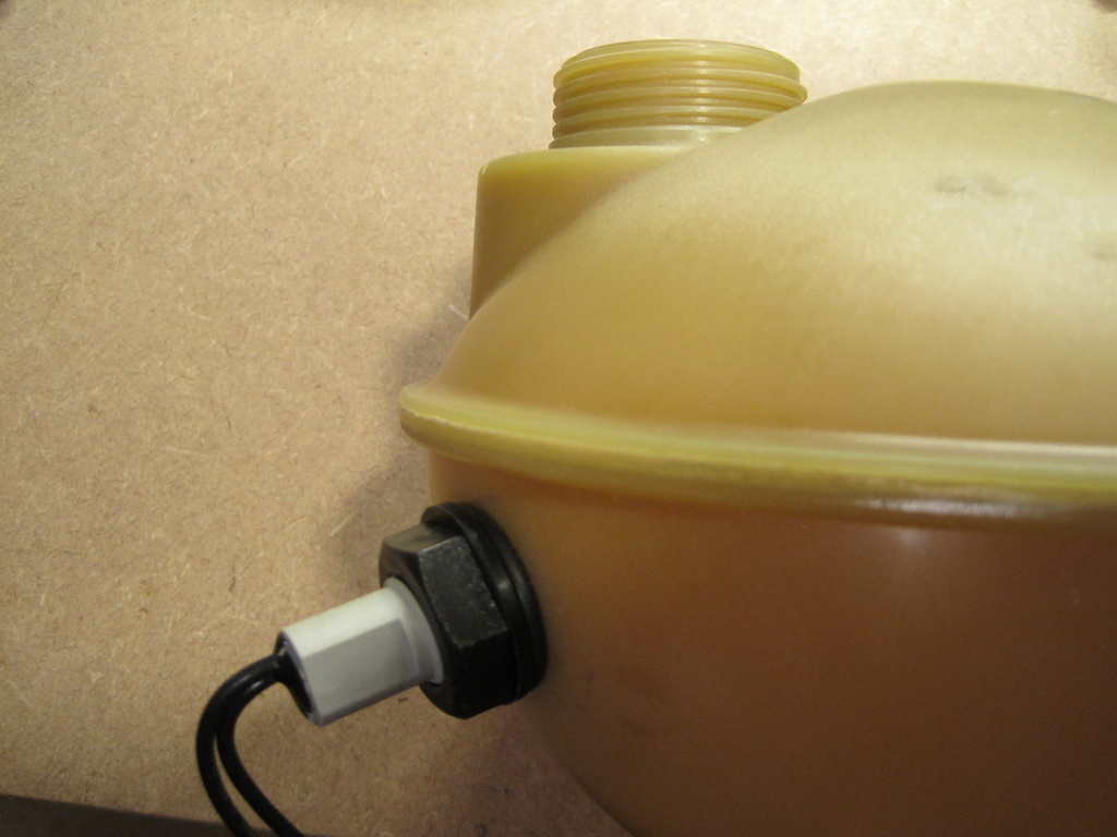

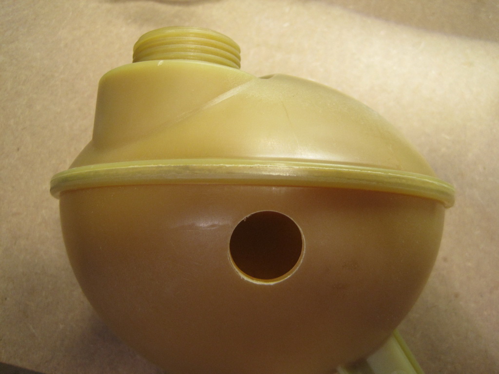

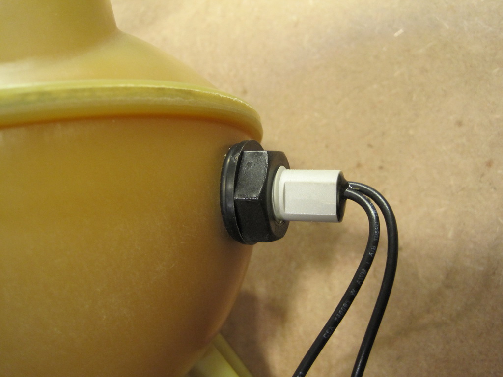

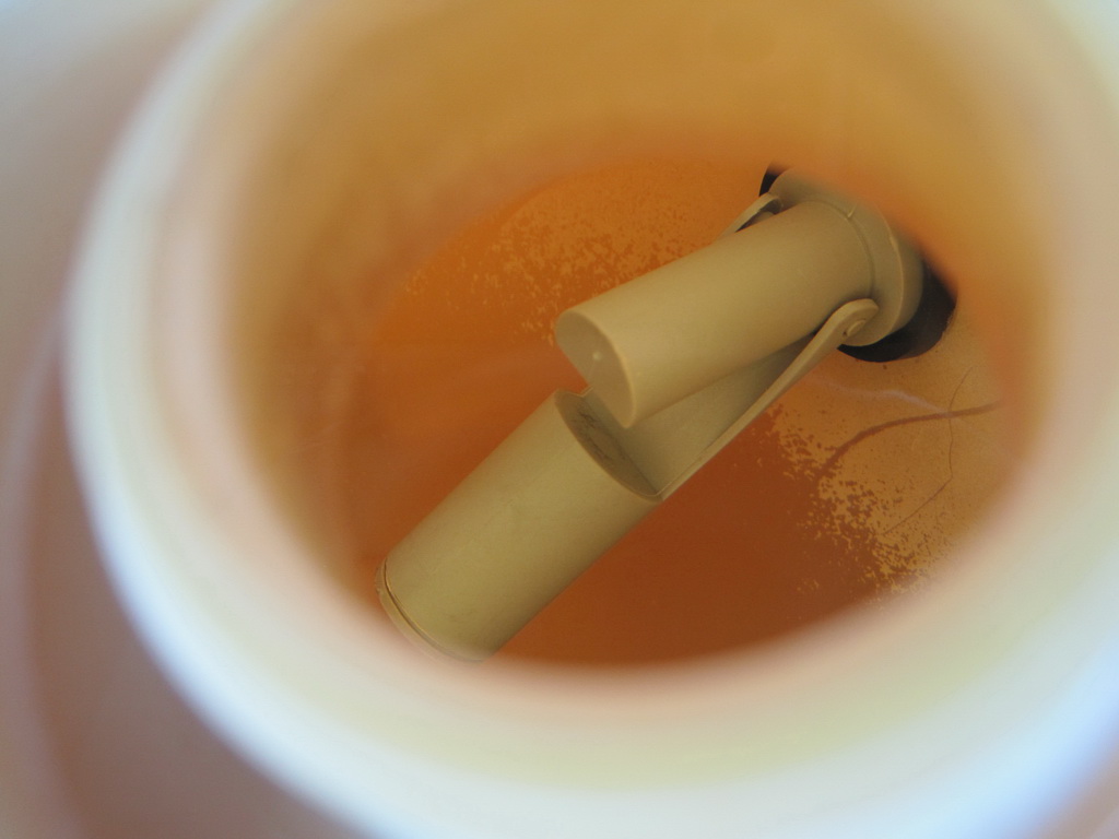

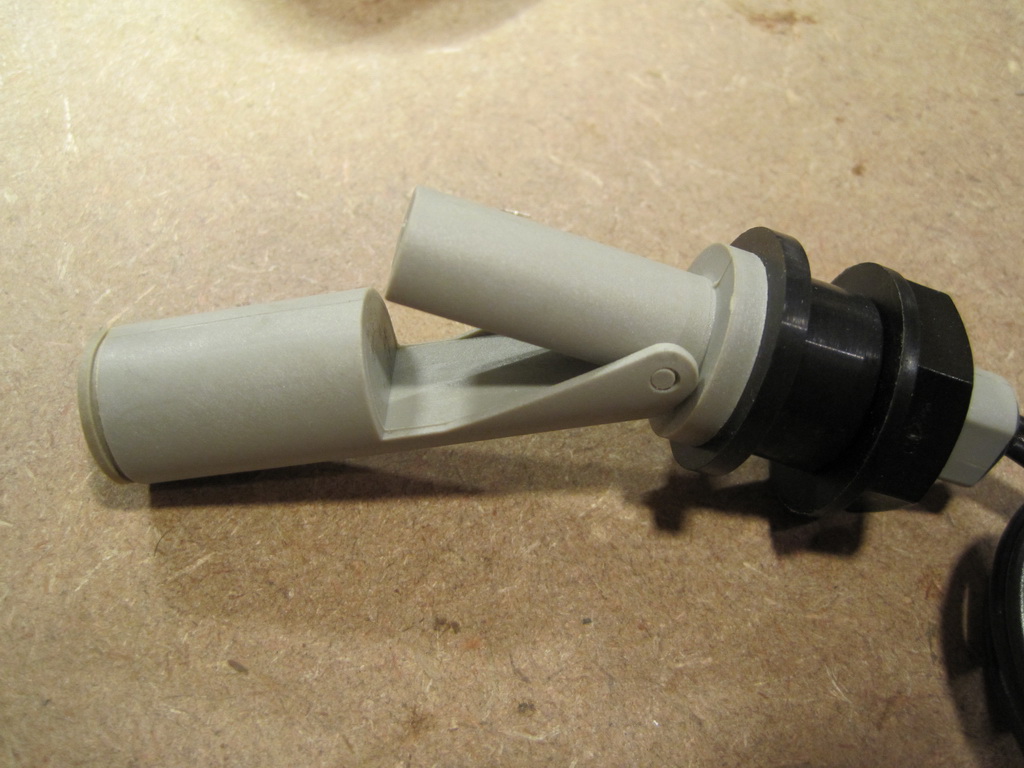

Installed a float switch specifically selected for being apt to work in temperature environments up to 120 C.
Float switch by CYNERGY3 model RSF76Y100RN <spec_sheet>
Positioned it in a way, or at least intended to, such that it closes when the coolant level drops below half way between the Equator and the Southern Pole in the header tank...
If it's connected straight forwardly to an audible or visual alarm will obviously give a lot of falses due to fluid movement in the header, so best to use a timer circuit of some sort.
Photos below.
HTH
M
