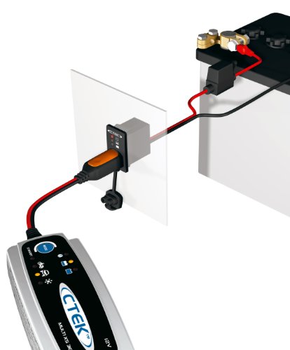

The anderson plug isnt a good solution for a battery charger. Jump cables will require large diameter cable, whereas a battery charger needs quite small diameter cable. There are different size anderson plugs but I wouldnt mix the boxes up.
For jump leads I would mount the anderson plug on the front of seat box and drill a hole through, grommet it etc. Couple of reasons. It keeps the cable length small and therefore less chance of a future short. It also keeps the plug out of the weather which will protect it from damage etc.
The CTEK comfort panel indicator is a great solution for charging. Gives you a visual indicator on the dash or wherever, and then you can easily just plug in your CTEK.
The issue I have is I need multiple use, compressor point-jump lead point & charging point. I already have a couple of optimates (which you could use the panel din connector) but I'm not keen on drilling two lots of holes in the seat box. As long as the Optimat leads are soldiered well & then secured to the plug as per Brendan's advice I can't see any other way of doing it (apart from doubling up on the holes that is.
