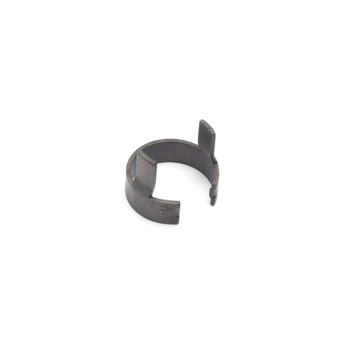

Hi Alun, just going back to the beginning, I assume this is your old wheel with prongs:
These are not removable as they are part of the machined boss.
Earlier wheels have a cancelling ring as a separate part which is made of sprung steel, so it grips the steering wheel boss tightly:
It's part number NRC7636 and £9 from a LR dealer before any discount. Not £25 Confused

Here's the prong ring fitted to a wheel:

Thanks very much for the thorough reply! I was just logging back on to close the thread as I'd managed to find the snap link yesterday and picked it up from the dealer this morning. £8.70 with the VAT. So all sorted now!! Smile
