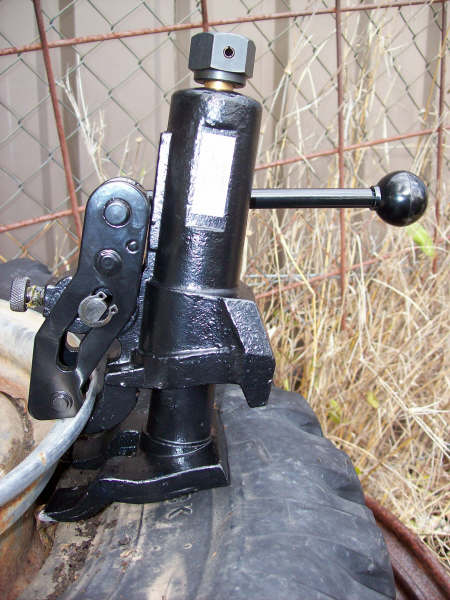

Not much difference between ally or steel when changing a tyre in the field. if you carry the kit to do the job Thumbs Up Having said that the 18" Mach5s with Cooper STT are the easiest to remove/replace you could do this with a T spoon.
I have one of these and a couple of good tyre leavers. Even 19" MTR's dont pose a problem.
