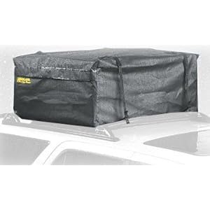

In our case we use frecuently the roof rack. (6-7 persons plus a dog) At the first step, we covered the roof rack with a perforated 9 mm plywood to do not damage the roof. The plywood are joined to the roof bars trhrough U bolts with 2 sets of nuts that are hooked to the bars, and are used as a eyes to fit the rachets and straps. ![]() Probably in the near future we will replace it for a metalic mesh to reduce the weigth. For the luggage we use a pair of soft waterproof bags like that, that are enough to all the stuffs that we carry and have its own straps to secure it to the rack. Not expensive and easy to storage when not in use. ![]() For the other things (bicycles, fuel cans, boxes, etc we use rachets to keep all firmly. A photo of the defender fully loaded ![]() ![]() Click image to enlarge Eduardo MY 2007 110 SW PUMA 2.4: Big Fog of 64' MY 1994 Jayco 1207 Folding camper: "El Tremendo" ![]() Click image to enlarge |
