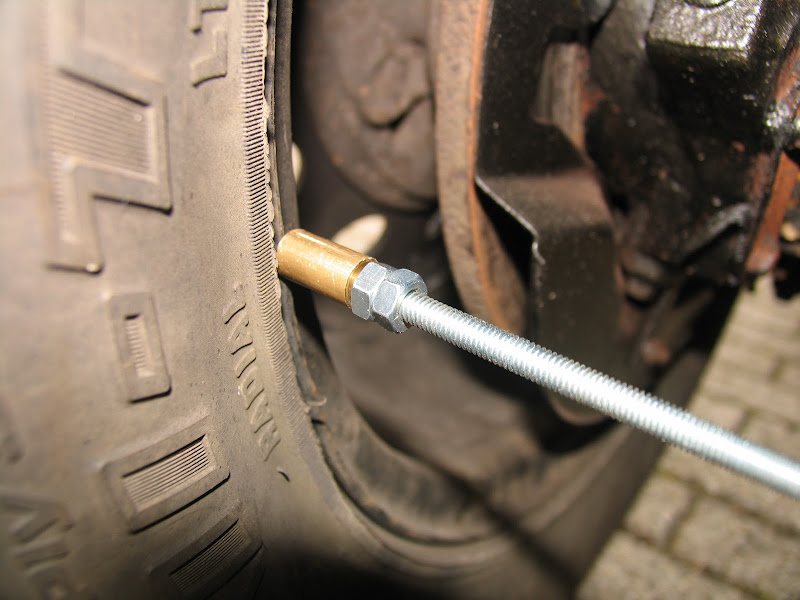

Then the next problem was 1 uneven wearing tire (right front). I researched what could be done with the suspension geometry and all that was possible was the tracking of the front wheels. So I made a little tool so I could do it myself. I lifted the front axle from the ground and checked for play on the bearings, just in case. That seemed fine. So next up was measuring the difference between the front of the rims and the rear. It had several mm toe in. While it needs 0-2mm toe out.
The tool is an M6 stud with a 2 bolts locked on each other on 1 side
And 2 bolts and a threaded piece of brass on the other side. I used 2 bolts on this side so that I could lock them together after measuring the small side of the wheel. Then I could move the brass piece out when measuring the other side of the wheel so. With the bolts still in the position of the small side, I could measure the distance between the bolts and the brass to measure the toe in/out. After I measured one side of the wheel I turned the wheel 180 degrees so that if it would be mounted crooked, that error would be corrected.
That was all done in september. But I can't see if it has worked because I haven't even driven 1000km with it yet.

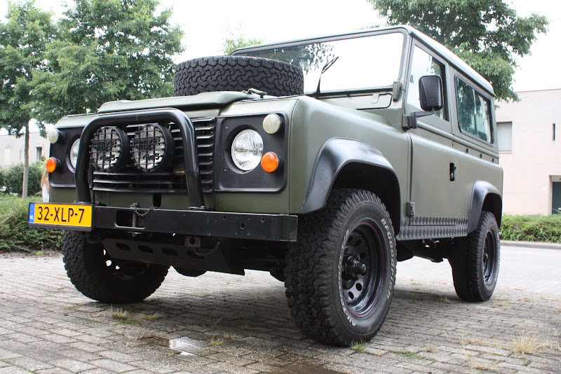

But i did take it for a drive today after the first snow fall.
And a small vid. https://picasaweb.google.com/1169023690551...7839947602 Scaling the real deal.

ZeDefender
Member Since: 15 Sep 2011
Location: Munich
Posts: 4731
Very nice - you should be proud Thumbs Up
Probably just me but I think it looks "80s" - which is how it should be Smile Tell someone you love them today because life is short.
Post #191633 7th Dec 2012 5:01pm
MartinK
Member Since: 02 Mar 2011
Location: Clackmannanshire
Posts: 2681
Looking awesome IKke - I'll bet you are well (justifiably) chuffed with her Thumbs Up Defender "Puma" 2.4 110 County Utility (possibly the last of the 2.4's)
Post #191636 7th Dec 2012 5:02pm
Maverick
Member Since: 08 Mar 2008
Location: Inverurie!
Posts: 261
Scotland 1996 Defender 90 300 Tdi CSW Alpine White
Wish I'd painted mine Nato green now, thats smart mate! Thumbs Up Ben
