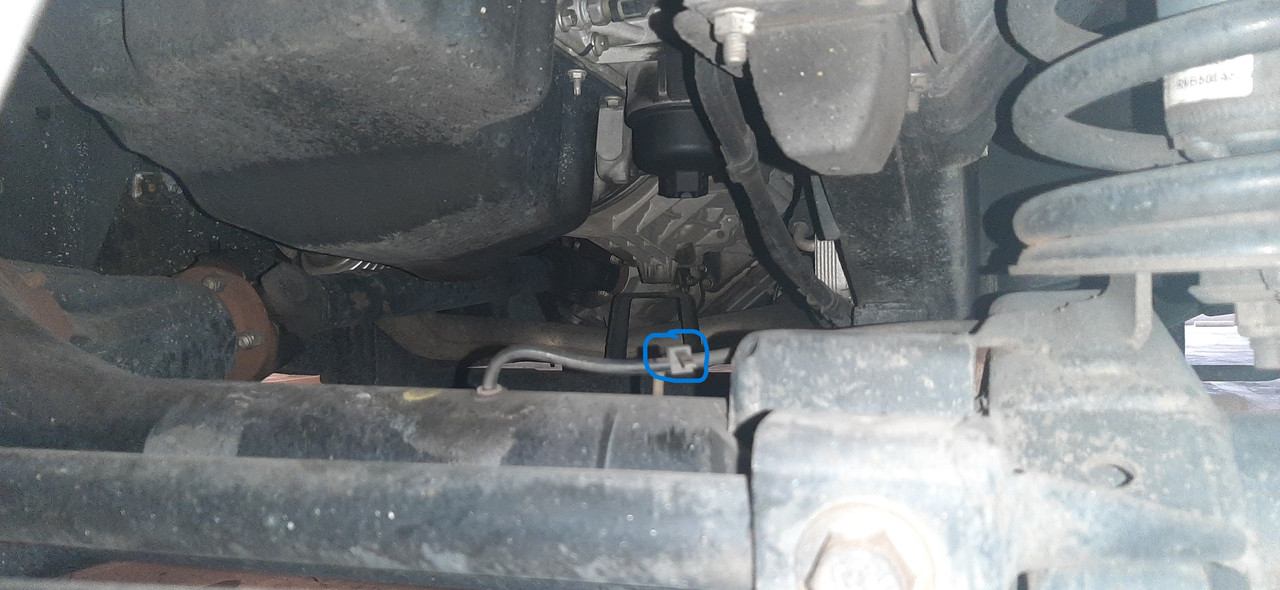

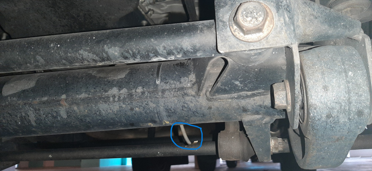

Hi guys. Long time since my last post so i hope you are all well. I need some clarification/guidance here.
I just noticed that, some zip tie has been broken, and i saw it long time ago, when i got truck brand new from Land Rover. Im not sure what is actual purpose/securing function of this zip tie and do i need to fix it again. Its on front axle. Take a look at pics and please instruct.

It looks like the zip tie that holds the diff breather pipe to the front axle.

Just pull out the snapped cable tie, and thread a new cable tie through the pipe clip. Reattach to axle and cut off excess.
