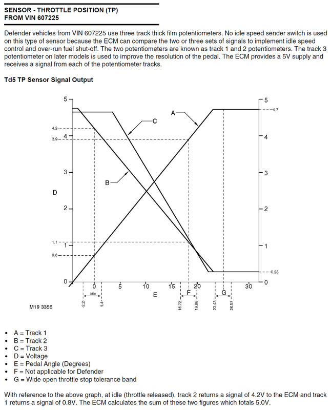

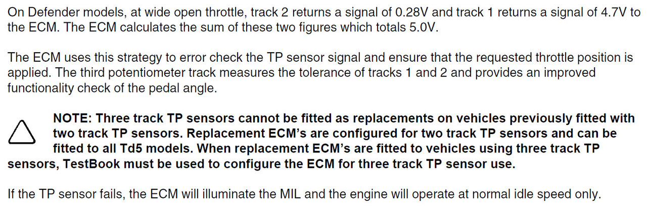

Two way gas pedal - supply voltage approx. 5 V, track 1 + track 2 = supply voltage, track 1 voltage is rising when gas pedal is pressed down, track 2 voltage is lowering. Track 3 is there only to help, just switch to 2 way gas pedal in engine settings (next to injector codes), to eliminate (for test only) the track 3.
Voltage range should be 0,5 to 4,5 V approx., and withnout any sudden changes - it must change smooth when pressing or releasin the gas pedal.
Any problem with gas pedal results in idle RPM only - this is security feature of engine ECU. When ECU is not 100% sure in what position the gas pedal is, it just switches to safe response, running engine only on idle RPM. "Drobek" = The Small One - Discovery 2, "Blufínek" = The Blue Thing - Defender 130, and for me at least Ford Mondeo Smile

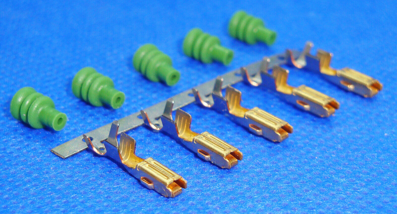

The solution, a lot less financially impacting than a replacement TPS, though more labour intensive, is an 'electrical bypass' by way of an overlay harness. A DIY job. Can source a TPS connector kit and ECU connector terminals from PaulMc, a valued member of this forum, who also happens to offer these items on fleabay:
https://www.ebay.co.uk/itm/161471327339
https://www.ebay.co.uk/itm/165540997395
Respectively:
There is a pre-wired version of the TPS connector on offer, saves some of the work, but the long term reliability of the wire splicing is questionable at best.

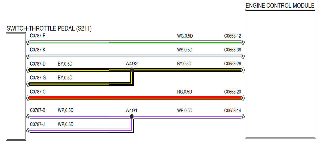

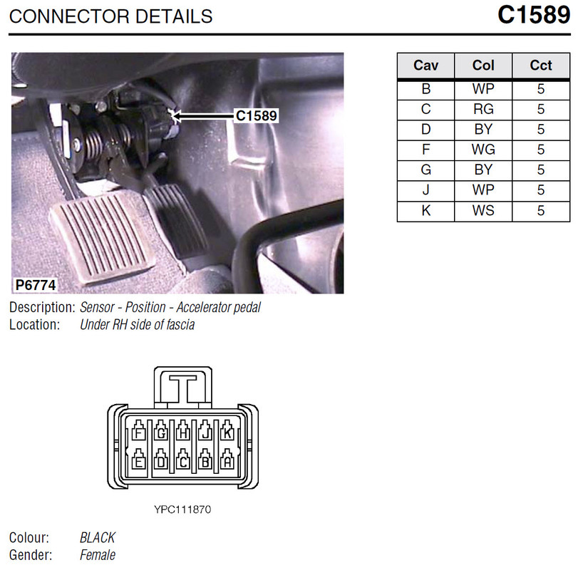

For the sake of completeness, a simplified wiring schematic for the TPS-to-ECU overlay harness, plus pinout diagrams of the involved connectors.
Enjoy!

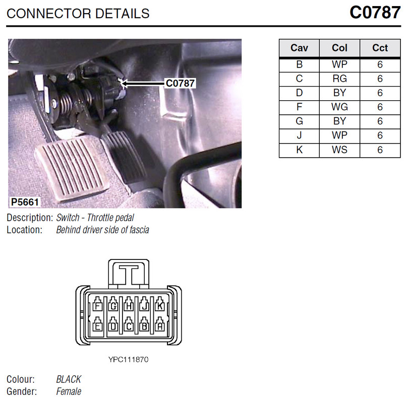

As it turns out the above is for the 'Export' model i.e. LHD.
For the RHD version the TPS connector is C0787:
And the wiring schematic (no changes other than connector name):
