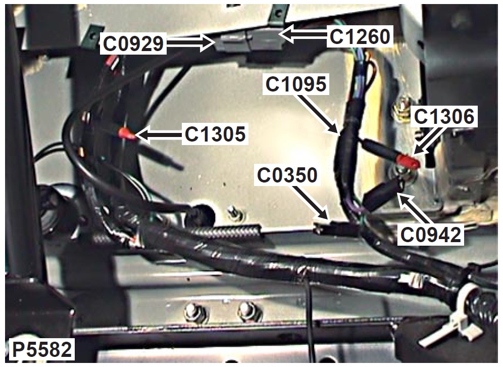

Your 2nd diagram from the 99MY wiring diagrams is wrong.
There's no diode in the accessory socket wiring.
The purple wire (accessory socket permanent live) isn't connected to the red/yellow wire (rear fog lamps).
Furthermore, C1305 and C1306 do not connect together, as shown in that diagram, they are female bullets (with red blanking caps) on the accessory socket purple wires.
C1305 is on the vehicle side of the 9-way towing pickup connector (C0929), and C1306 is on the towing loom side of the 9-way towing pickup connector (C1260), (along with C0350) -
This diagram shows the correct wiring for the rear fog lamps -
The diode is in the rear fog lamp circuit (red/yellow wire) on the towing loom, between the 9-way towing pickup connector (C1260), and the 7N trailer connector (C0499)

I think it's one of the (many) mistakes on the 1999MY wiring diagrams.
That diode actually sits in the fog light supply to the trailer socket with no splice into the socket side, see https://www.lrworkshop.com/wiring-diagram/...s/fog-rear
If it was connected as shown in the power dist. diagram, splice A6 would supply fog light pin of the trailer socket (C0499-2) with 12V at all times, so the trailer fog light on the would be permanently on. Confused
This error in the 1999MY diagram is backed up by the 2002MY and Puma diagrams which are correct.
Also, C1306 and C1306 (which seem to be single bullet sockets) in the 1999MY elec library are shown NOT connected together: https://www.lrworkshop.com/connectors/defender-1999/C1305  1988 90 Td5 NAS soft top

It's on the fog light wire in the trailer loom that plugs into the socket on the chassis loom, it's not on the chassis loom.
From the elec lib it would have been something like an SR5100 diode crimped onto wires, with a heatshrink cap over the top, then taped into the loom.
https://www.lrworkshop.com/connectors/defender-1999/C1095
But again, not on the purple wire in the chassis loom.  1988 90 Td5 NAS soft top

Doesn't look to me like there was anything there, the cable's corroded badly and puffed up I think.  1988 90 Td5 NAS soft top
