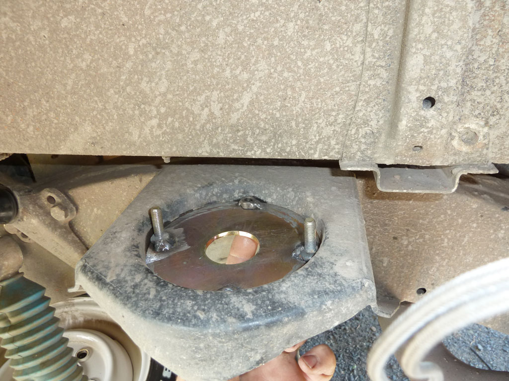

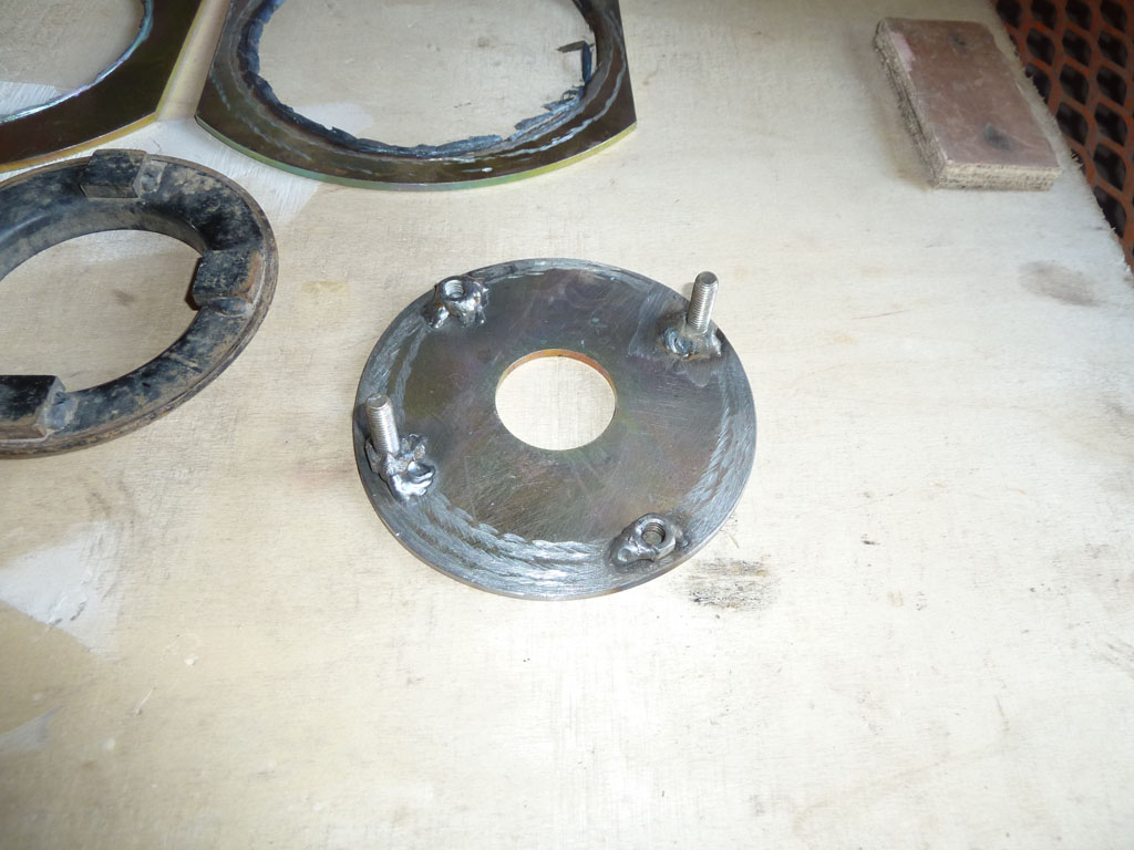

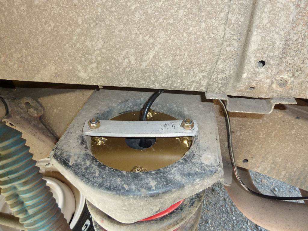

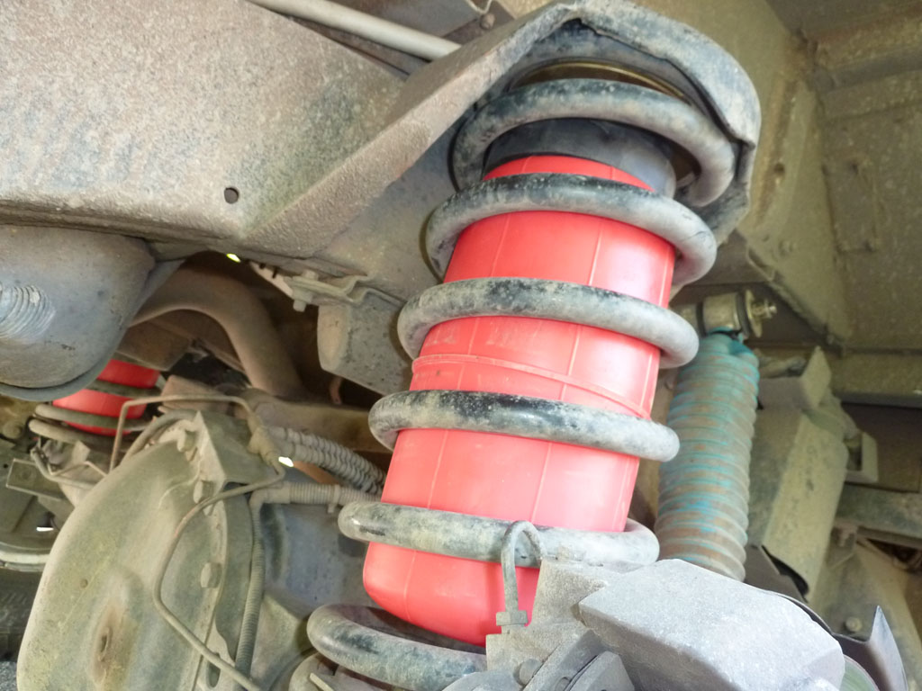

the general consensus it is not a good idea to raise the ride height of a Puma But there are times you need to carry a large weight & the standard suspension is not adequate. Thats where Polyair Springs or Firestone Coil-rite springs come into their own. Once fitted the Defender rides as if on original suspension until you jack it up by filling the airbags from a regular schraeder valve. Im no engineer but the top retainer plate that comes with the Defender polyair kit is a JOKE, Image below shows standard polyair top retainer plate that comes with the kit (on LEFT) It is supposed to bolt to the TOP of the spring support - which is stupid, It should go underneath. (Plus the spring would rub thru the bolts) My idea is to cut out a plate that sits under the top mount using the 130 inner spring retainer as a template, You can tell I'm no engineer by the way Ive hacked at the retaining plate with an angle grinder (where theres a will theres a way) ![]() Click image to enlarge Step 2 ![]() Click image to enlarge Test fit ![]() Click image to enlarge All fitted up ![]() Click image to enlarge For all intents & purposes Polyair Springs & Firestone Coil rites are the same thing, but Polyairs are REd & Firestones are Blue, they sit inside your standard Defender coil spring. ![]() Click image to enlarge schraeder valves on rear, pump up with a normal tyre pump ![]() Click image to enlarge for about $250-$300 its much cheaper than a lift kit and wont wreck your puma. you dont have to drill any holes in your car either (you might have noticed my Salisbury & realised I don't have a Puma at all but for the argument everything else is identical to my Td5 ) |

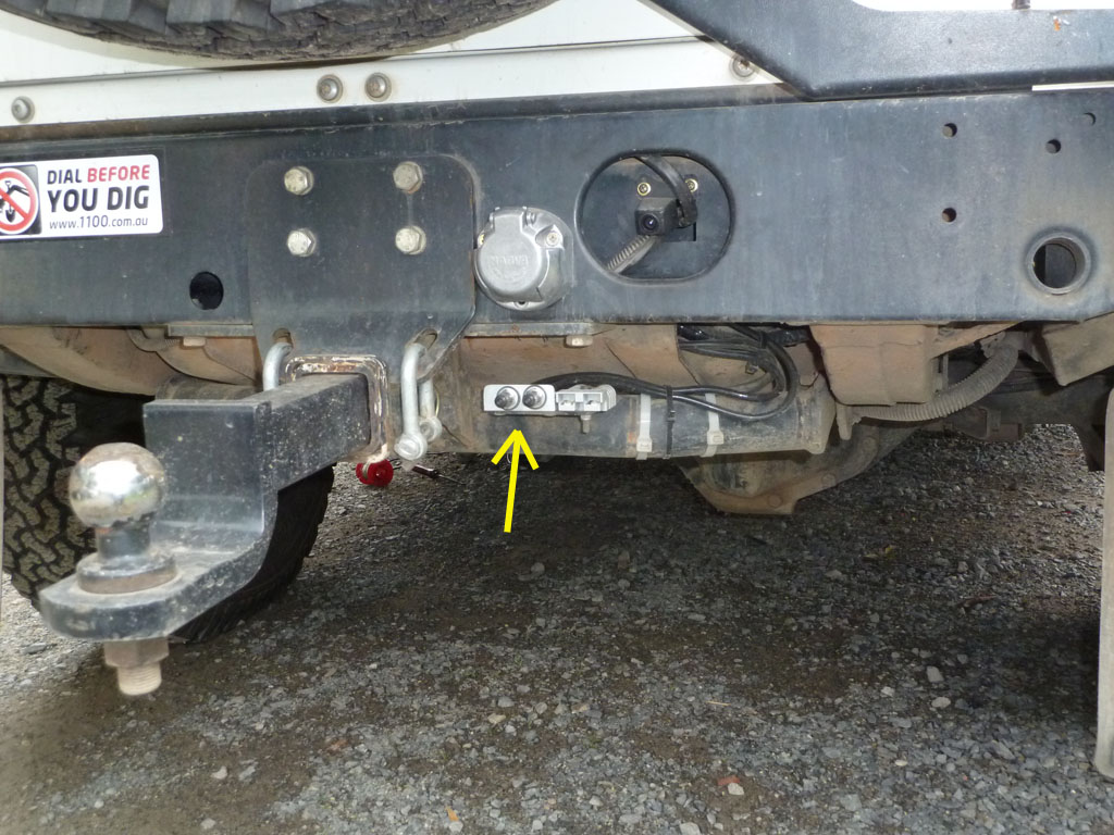

![]() Regards Craig 2015 110 USW XS in Santorini with premium contrast leather seats in tan/black, black headlining and with Dual Finish alloys (in the garage, now on Wolf rims with Goodyear MT/Rs) 2012 '62' 2.2 X-Tech 110 USW now gone ... 1984 90 soft top with full roll cage, 200 tdi engine etc now sold 2012 USW XS 2.2 "FUU" now gone.... |
quentin Member Since: 23 Jul 2012 Location: on tour Posts: 119 ![]() ![]() ![]() |
Yes thats the Landrover AU supplied tow bar, The other common style is the Hayman Reese which has a straight 2" square bar going across under the tank instead of the curved round LR version. For some reason when you look up LR Australia website & look at current model towing options they show the UK version which does not get fitted here, Meybe it dosent meet the Au standard ?? are the UK bars rated at 3500kg ?? |
